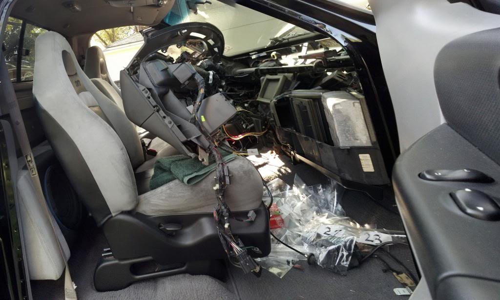

my heatercore started leaking as a result of a head gasket that was going out. the leaking headgasket put too much pressure on coolant system and the heater core was the weakest link. i found oil contamination in my coolant. hopefully, yours is just a leaking heater core. theres a couple good articles with pics & everything. here's one of them: https://www.f150online.com/forums/hv...-pictures.html the word documents are what really helped. print them out.
I got about 30 baggies and put the screws from each page in it, makes reassembly much easier. driver side seat had to be moved all the way back to drop the steering column. take lots of pictures for yourself. it really wasn't that bad, you can do it over a weekend. make sure you get a good small cordless drill with the right bits. i picked up the heater core from local ford with them matching tousley's price. i also made sure to get the foam wrap that goes around the core. while i purchase new lines, i didn't install them.
