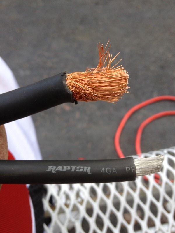

I highly recommend welding cable for this "how to"! It is super flexible and you do not need any plastic covers. It is highly durable and over 99% copper. Please be aware any wire containing ALUMINUM is not a good choice. Although the aluminum clad wire is cheaper, it does not conduct nearly as good as copper. So choose your materials appropriately.
• Approximately 10 feet of flexible 1/0 high-strand wire (measure your vehicle’s existing wiring with a string to be sure, and overestimate) An extra 12 feet if you decide to do the starter upgrade.

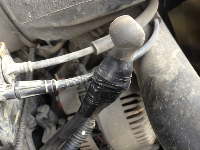

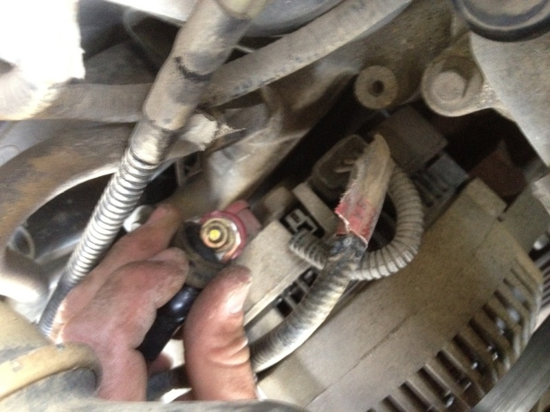

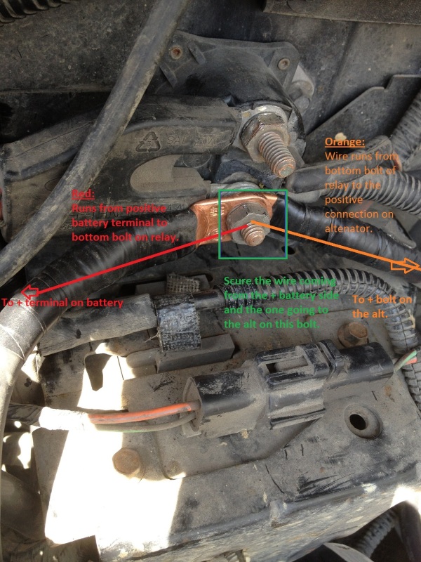

The first wire I added was the positive wire running from the (+) battery terminal to the stater relay, then to the alternator. I wanted to knock it out first since it required the most work (fusing). Go ahead and connect it to your positive terminal then to a fuse holder (without the fuse we will install that later). Out of the other end of the fuse holder run the wire to the bottom bolt on the starter relay. Once that is done you can go ahead and run the next wire from the same bolt on the relay to the pos. terminal (bolt) on the top of the alternator.

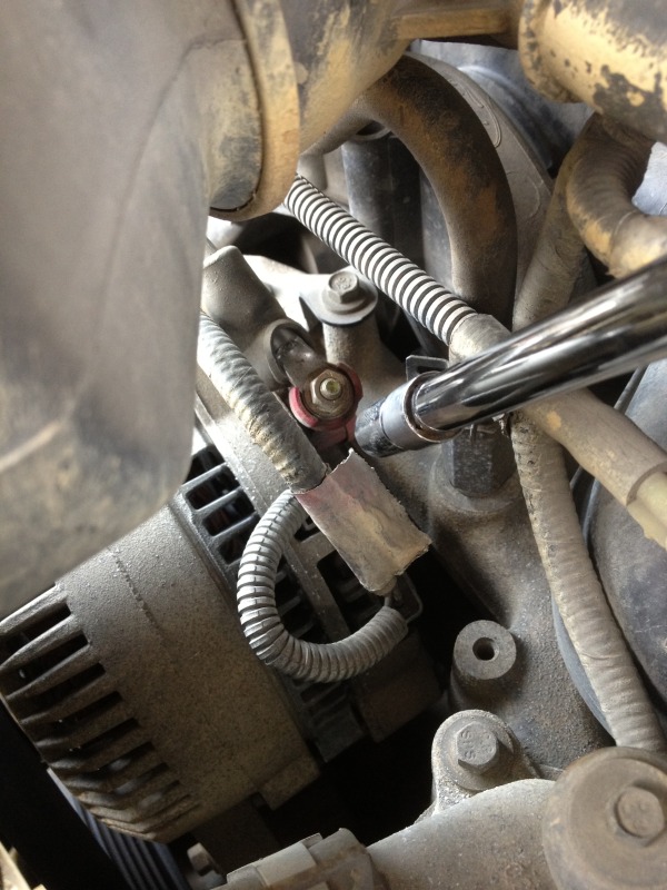

Here is the bolt you will be connecting to on the alt.
I kept my existing wiring, so I ran the bolt through both terminals on each wire and then connected it to the alt. then securely fasted them and put the rubber boot back on top.

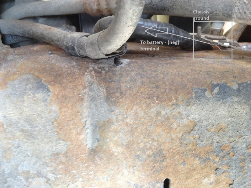

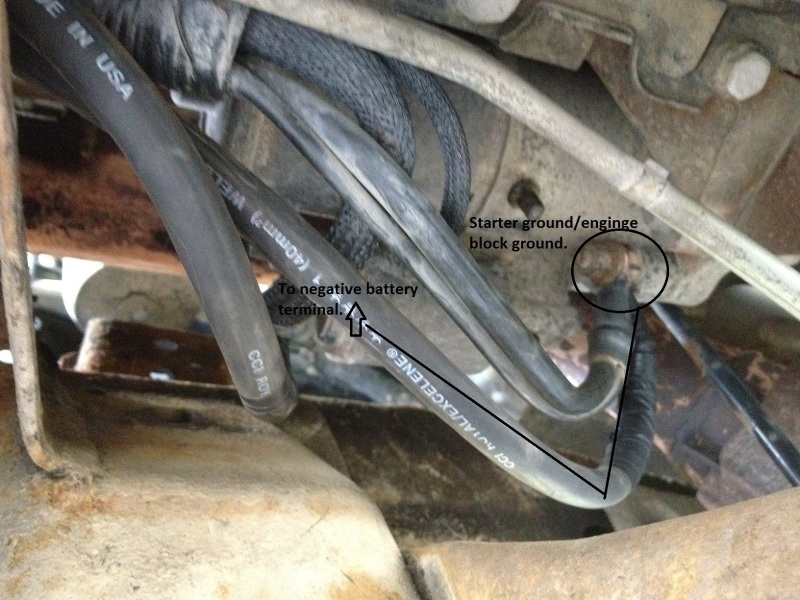

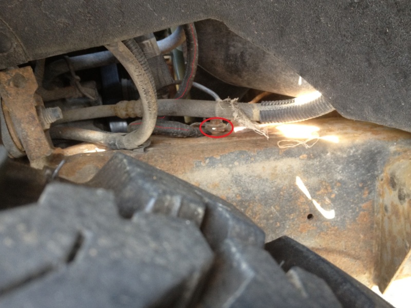

The second one I upgraded was the - battery to chassis ground/frame (big 4)

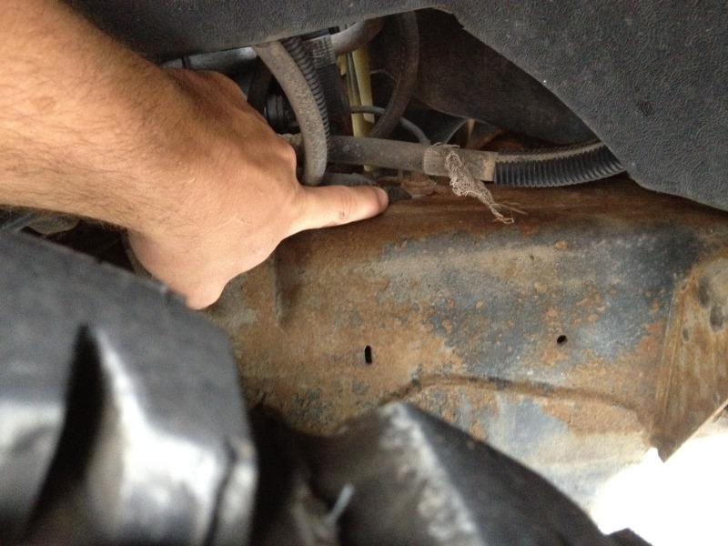

This runs directly from the - (neg) battery terminal to a bolt on the chassis/frame. This bolt is located right under the passenger side fender well. Make sure to clean up the connection area by sanding or buffing the contact location.
Again, this runs directly from the bolt shown to the neg post on the battery.
*For the big 4*

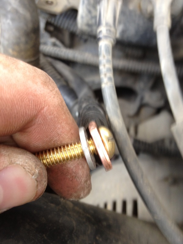

Run the another strand of wire, connecting it to the chassis then attaching it to the same bolt used in step 2. This helps to keep a solid ground throughout the truck.

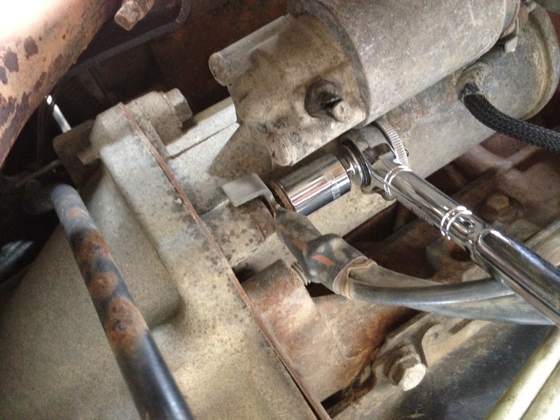

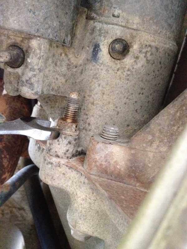

Step 3 - Engine block to ground. (I kept the factory engine block ground) but decided to use the starter/block ground instead. Considering your starter takes more amps than any other device on the truck, I thought this is the best place to do the engine ground since it connects to both the starter ground and block ground.
Here is the bolt we will need to loosen for the connection. Note: their are two nuts on this bolt! The back one holds the gasket secure so make sure and not let this come loose(Keep a wrench on it at all times when loosening).
*For the big 4*
Once you have the top nut off, make sure the back bolt is secure.
Then again I kept the existing wiring and doubled them up. This wire runs from the starter/block ground to your main ground (the one is step two) or you can choose to run it directly to the - (neg) battery terminal. Both work relatively the same, only the latter of the two takes up more wire.

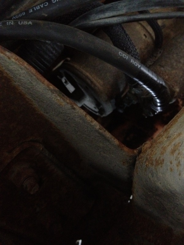

Considering how harsh our winters are here, I wanted to gain as much starter power as I could, so I decided to upgrade the + starter wire as well. This will make sure as much current as possible goes into cranking. Below are steps.
If you look on the opposite side of the starter (as the ground) you will see a lil red cap covering two bolts on your starter solenoid. The larger one on the left with the heavy ga wire is the one we are interested in. Its covered with a nylon coating (not where my socket is)
Once you have located the bolt run your heavy gauge wire from that bolt to the starter relay bottom bolt (on your firewall). You should already have two terminals added here, this will make the third. Current is always flowing from this location so be careful when doing this an not hit your wrench on the top bolt(ignition lead). Once you have the terminal connected to the bottom bolt, securely tightly and enjoy your work. This will dramatically increase the amperage going to your system and your starter for long lasting power.
Then install your fuse (the one that runs from the battery to the relay) and re-attach all your battery terminals to the post.

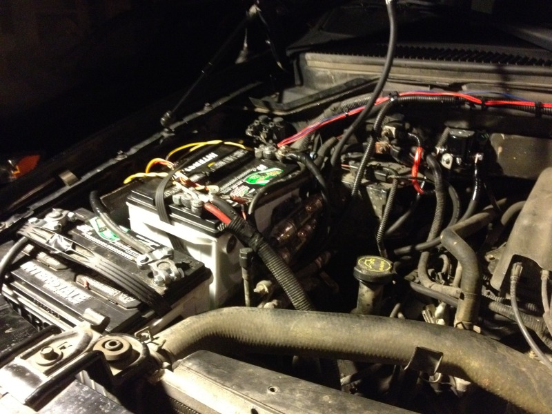

Another side note: I Installed an extra battery and starter relay, so follow the instructions step by step, try not to follow wires, it can get confusing. Make sure to securely zip tie and shrink wrap/tape all connections and terminals.
