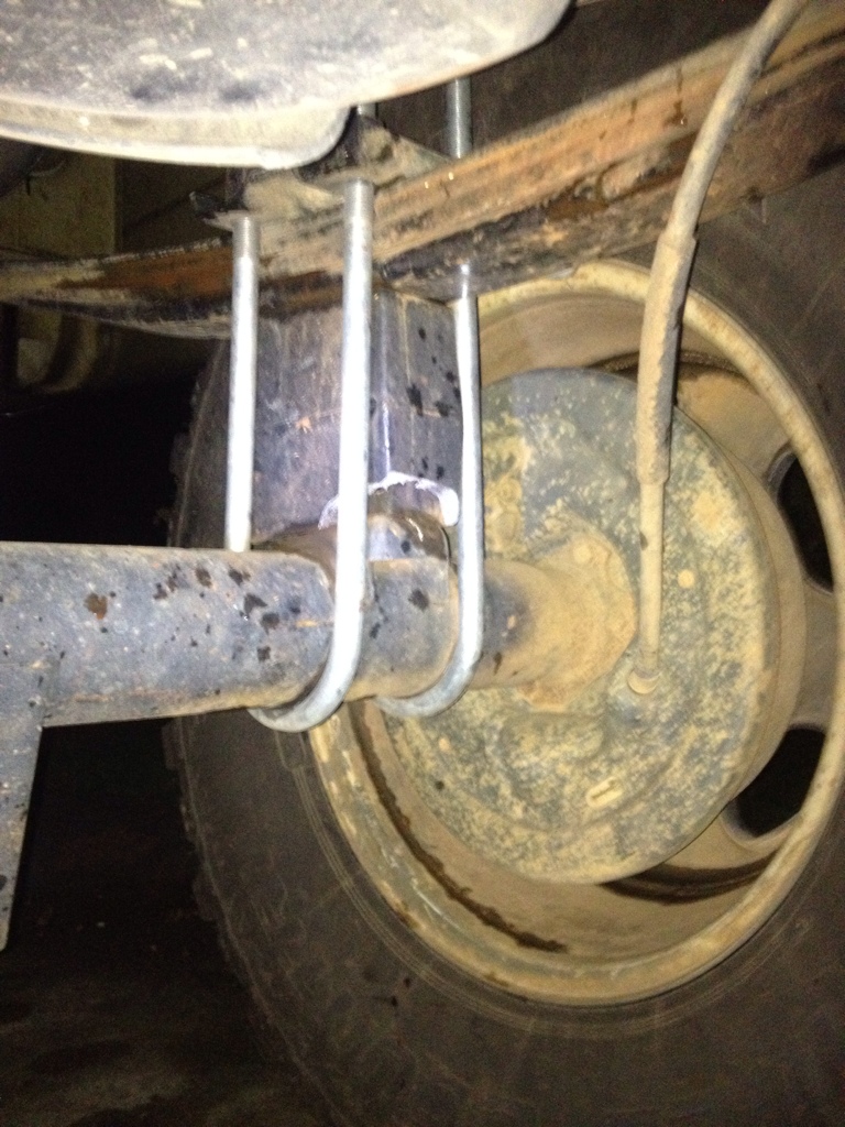

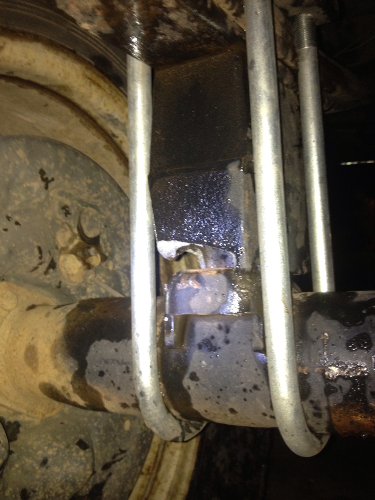

I am so pissed off at my self right now...............
Both of my rear blocks have chunks missing, both shocks have HUGE dents in the axle side of their bodies, and my U-joint is beat to ****..........
I almost wanted to puke......

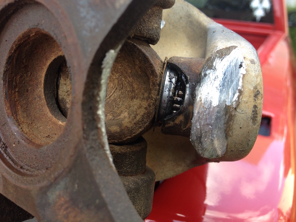

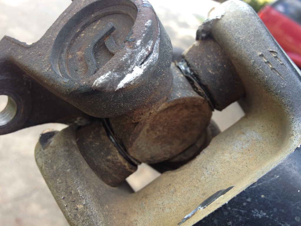

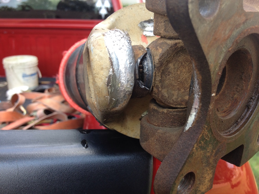

When you extend the U bolts that far the springs have less control of axle windup so those things happen when a lot of torque is applied.
You also need to be concerned about the U joint pulling to far out of the transmission tailshaft housing.
Good luck.

well my plan at this point is full size leaf springs ( 5" Skyjacker Leafs) and add my 2" add-a-leaf back. then go with shorter u-bolts

aluminum lift or lowering blocks have always been prone to cracking too
it's really the wrong place to use aluminum sandwiched between to very active pieces of steel

Bars , -or a Hotchkiss set up. Summit sells bars pretty cheap, - they work !
There's cheap set ups or the more expensive ones, -both work. - Could of been worse, -as Bluegrass mentioned...

Get with performance metal fab (PMF) and they can build you a set of traction blocks. its a block with integrated mount for traction bars. beefy as **** and will handle what you can throw at them.

its all fixed now, well blocks anyway. went back to my 4.5" solid lift blocks. calling my parts guy today to see if i can get my money back... bet that goes over like a lead balloon.

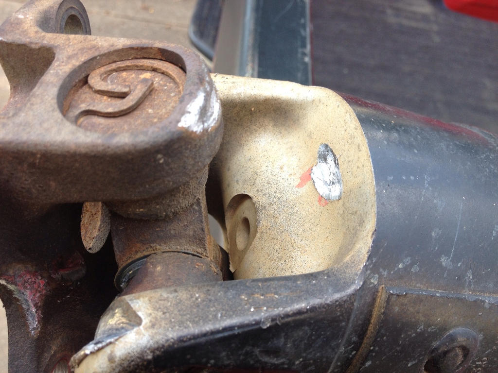

well. im getting a new drive shaft!

Ford wanted 1,333.33 for the drive shaft.
Autozone ordered me one for 307 + a core fee.
there goes my trail rig build.
