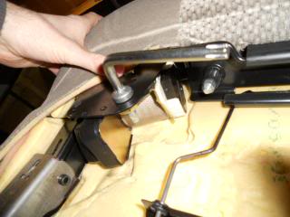

Posts: 82
From: Alaska
OK, I took it all apart. First thing you'll need is a Torx t25 bit. There are 4 fasteners on the plastic cover, and 2 more on the metal strap shown here:
Next remove the hard plastic cover on the seat back. There are 2 push pin type fasteners on the bottom, the top and sides just hook over the wire that's around the edge of the seat. After removing a rubber cover, it looks like the following. There is one bolt (Torx50) and a tab holding on the spool:
After removing the spool, careful removing the black cover over the spring on the right, this is what happened to me (YIKES!):
It is possible to put it back. It was clean and well lubed, so I just made sure to wind it tighter. In fact I got it too tight and it wouldn't reach around my waist, and I'm a skinny guy. I had to take it apart again and let a couple coils out:
The retraction of the belt was better, but still sluggish. As suggested, I used some dry lube on the guide shown here. It's really improved, before I put all the covers back on I'll try it for a few days:
The other side is the inertia assembly which catches the belt in an accident type situation. It has a weight and a ball. It still works fine:
