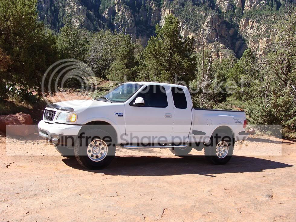

I put 315/70R17 BFG AT on my 03 SCAB with the flareside bed. It technically measures out at 34.6" x 12.4" I believe. I cranked the torsion bars in the front 2.25" and trimmed a bit off the lower valence where the fog lights sit. I also put a 2.5" taller block in the rear but that wasn't necessary for the tires, I just wanted to keep my rake.
I am VERY pleased with this setup and have put about 6,000 miles on it since the beginning of March. Only managed to stuff a tire once and I came down hard enough and at such an angle that I think it may have done it with the stock tires.
My total setup including alignment, tires, rims and what I spent to lift my truck up (new u-bolts and blocks) came in right around $1400. Oh, I'm running MB 72s that are 17"x8.5" but I'm not sure on the backspacing.

So no rubbing under normal driving conditions? I know the height would be fine on the 325/60's. I was more worried about the width rubbing at full lock.. Especially since i'm not wanting to go any farther on the t-bars than it takes to level it out.. But if those 315's fit @35" tall it should be fine i think??

About 2" on the t-bars is all it should take to level it out. I have absolutely no rubbing issues at all during the day. Which for me includes countless speed bumps and driving over curbs to get to parking spaces. Lock to lock on the steering and I have no rubbing on any of the front suspension or steering components.
I got my rims and tires at Discount Tire in Scottsdale, AZ. I originally did my lift thinking that I would only be able to fit a 33" tire and went in to put a set of 33x11.50 Pathfinder ATs on. Curious how close I was to fitting the 35s I had the sales guy mock one up and mount it on the truck. Low and behold it fit! I thought for sure that I was going to need at least a 4" lift to accomplish 35s. I am really happy I didn't as I now have the tire size I wanted with the least compromise to my center of balance on the truck.

Yeah it looks great!
