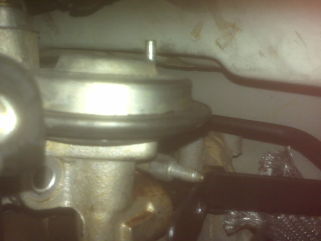

First off i am far from an experienced mechanic, however after reading up on the process of changing the EGR Valve i decided this was a job surely i could tackle. However, after removing all the nuts and bolts and making it to the very last bolt, i cannot get it to budge, it seems to be seized and cannot break it free. I will post pictures of what i am talking about. i am looking for suggestions on how to remove this bolt so i can replace the EGR Valve. This is the bolt that i cannot get unstuck, it is located mid pic and is sticking out directly from under the Valve Cap.

I used a 10mm deep socket and it snapped free... in two pieces. Ended up taking the elbow to a machine shop to get them to drill the bolt out. I hope you can get it free without breaking it. Have you tried spraying some penetrating lubricant?

Just as i feared, i have sprayed it with WD40 however didn't see any kind results. I hope i can get this off in one piece this evening, i have one of my buddy's coming over her take a look are it. Thanks

WD-40 is not a good penetrating oil - try PB Blaster or Seafoam Deep Creep.

I second the use of PB Blaster or Seafoam Deep Creep. Just spray them and wait awhile ( the hardest part...usually) sometimes it takes multiple spraying s but patience is key. Just spray once then go find something on tv come back in 30 mins if it still won't budge spray again and find something else to watch for a bit....rinse and repeat until it's out. Some times some things need to sit over night some times 2 mins but patience is key. No patience = broken bolt = bigger pain in the rear.
Old Mar 16, 2010 | 07:31 PM
try penetrating oil, and its also sometimes worth a shot to tighten it slightly if possible to get the rust to break loose, then spray and soak it some more

Thanks fellas, my buddy came over to the house last night and brought his 10mm deep well socket and he applied a fair amount of pressure and it broke free..luckily in one piece. He ended up putting the new one in and everything back together in maybe 5 mins. I was relieved when he handed me the old one, and it was all gunked up!

i got that bolt out no problem, it was the first one that you got out that snapped on me!
