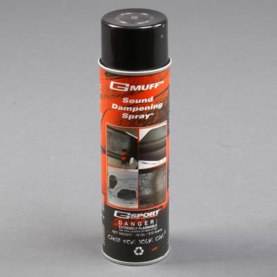

I'm not sure about fixing your rattles, but I did some sound deadning when i upgraded the audio in the truck about 7 or 8 years ago. I used a spray deadner product that came in a rattle can. I think I still have one laying around and i will check to see what brand it is, found it at a car audio place. I had to buy about 4 cans and I did all of the doors and behind the back seat against the back of the cab. It made a very big difference in the quality of sound from the stereo and a lot quieter when driving down the road.
It took some time, wasn't cheap but i thought it was worth it for the results at the end.

Since you don't won't to go that route, you could use something like what Blown F-150 suggested.....
Mr. Gasket Sound Damping Spray
