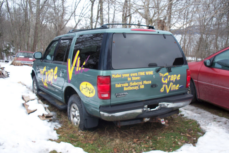

The Expeditions have the spare tire crank under the hatch and not part of the bumper, so I'm curious to see what F-150 bumpers look like...

Old Mar 2, 2010 | 08:13 PM
chrmar's Avatar
Joined: Jan 2010
Posts: 400
From: Saint John, NB
Aha! Looks like the Expedition's crank slot is in a little different spot...
Also old pic:
The hole is between the hatch and the bumper, just to the left of the top left license plate screw.
