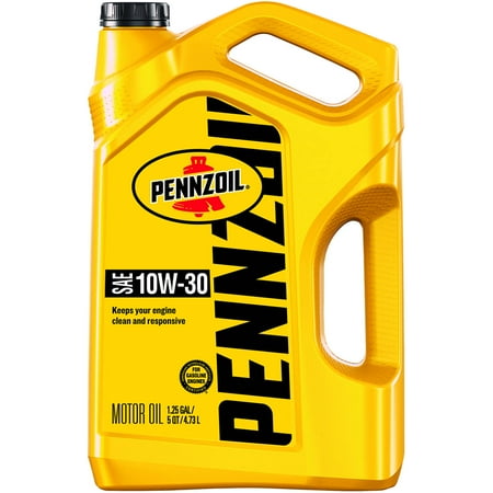

Run this oil no more than 2000 miles. Consider it a flush, kinda. Change it to a 10w-30 Pennzoil yellow bottle. NO additives. Use a quality filter. The Pennzoil yellow bottle has the absolute lowest NOACK which means it can tolerate more heat than any synthetic on the market and not cook off. It will go down to -25C during the winter so cold startup shouldn't be an issue unless you live in Alaska. I'd change the oil again with the same oil at 3000 miles. Most likely, with the cleaning agents in the Pennzoil yellow bottle, the engine will be reasonably clean after that. I'd suggest to continue using it until you get rid of the truck. Remember, no oil additives.
Motorcraft is a quality filter, Walmart should have them. Stay away from Fram.

Use the EXACT OIL that Labnerd recommended and what I quoted.........
In the winter, I'd probably use the same oil but in 5W30.

I dropped the oil and put in the 10W 30 Pennzoil in the yellow bottle. I also had the differential checked out and it's the pinion bearing apparently and maybe the main bearing, so got to save up to get that fixed now.

I just found out that all Pennzoil is in a yellow bottle now. Waiting on Labnerd to specify exactly which oil, there are 6 different ones.
Whichever one you used should be fine for now, just plan on 3000 mile changes to keep it clean.

Yeah, it slipped thru what little mind I have left that they have changed the packaging. The old yellow bottle is a conventional as labelled. The specs on it says it's a blended base oil.
