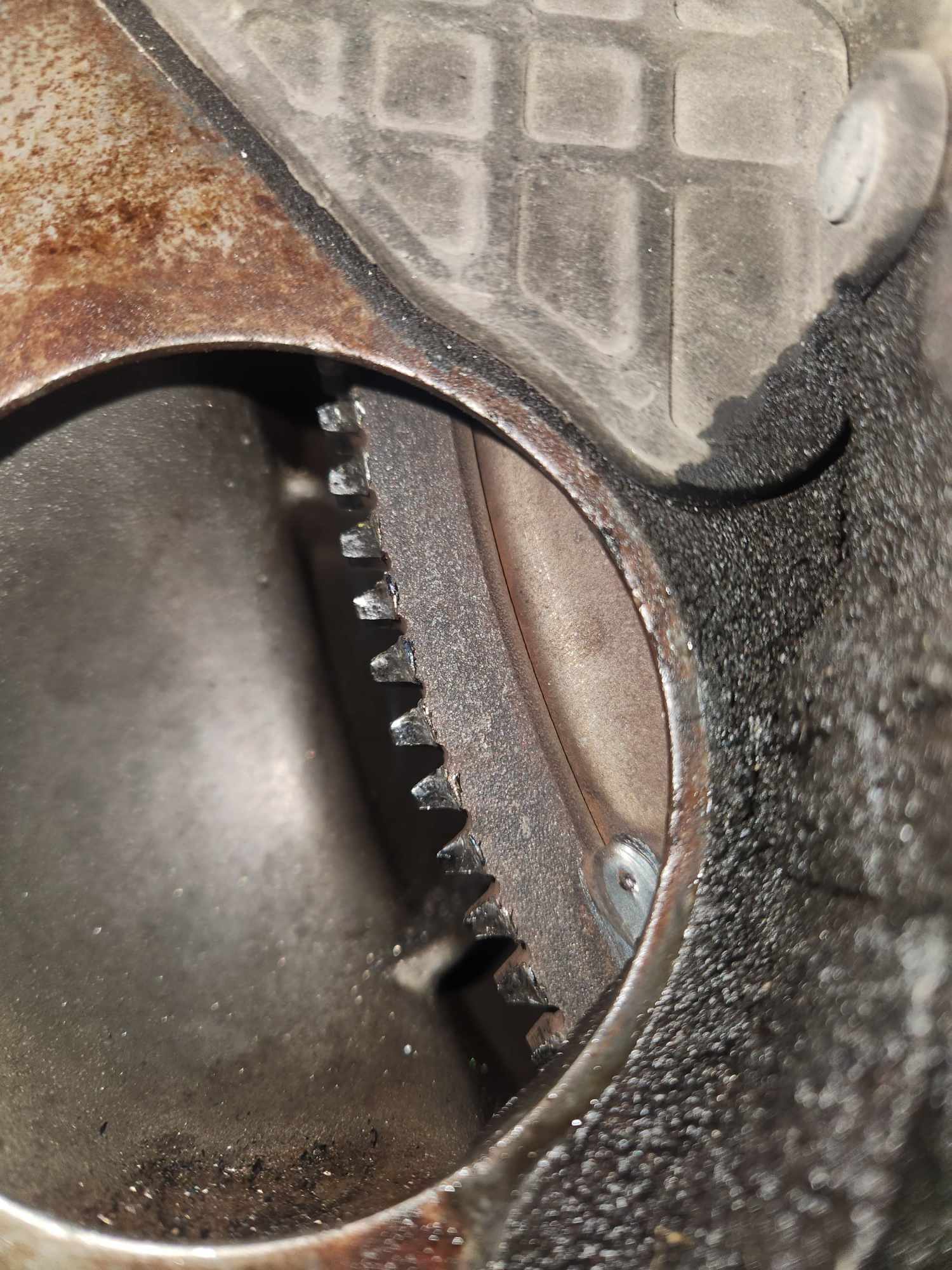

Spoke to service again and I’m okay with what they said. Then I called the shop who did the starter and he admitted and said he should have told the mechanic to check the teeth and said he dropped the ball! Ford did tell me they don’t usually see broken flywheeel teeth. But the shop said they’ll remove the starter and check for missing teeth at no charge. Wow had I not called him he may have never reached out to me. I was upset that he didn’t do what was nessissary His shop is extreamily busy but he knows this has been a long term problem. A bit disappointed he would go that route

Well, I’m doomed 😢😕😖. After he rotated the flywheel it’s toast. Truck is still drivable so I’m not turning the truck off so I can prevent another start. My dog will watch over her ride.

At the end of the day, the transmission needs to be pulled, and a new flex plate needs to be installed. The starter needs to be inspected and tested for proper operation before putting it back in service so it doesn't chew up a new flex plate.
Now that you have pictures of the problem, go to another shop and tell them you want a new flex plate and the starter tested and inspected.
