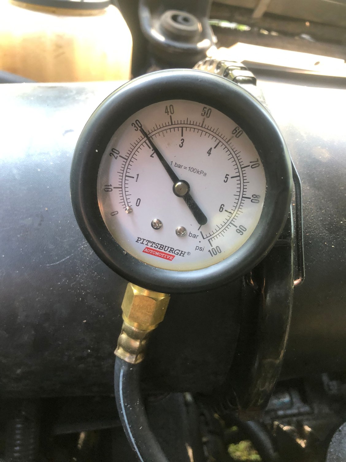

I went outside and it started right up it’s just under 30 psi right now running
Old Aug 5, 2023 | 05:05 PM
  #32
Posts: 43,538
That's just barely within specs. Did you read the 2 linked articles? Does the fuel pressure rise when you disconnect the vacuum to the FPR?

highest I saw was 30 psi and it would leak to 20

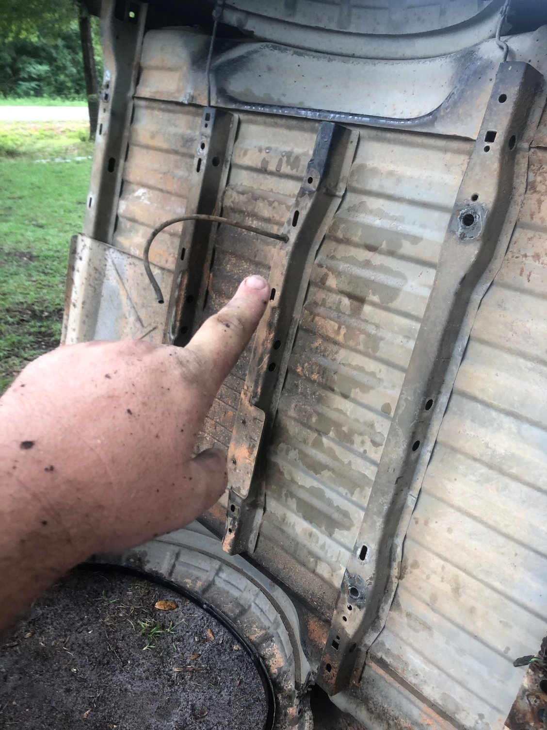

what is this line under the bed go to?
where do I disconnect vacuum to for?(

That line he's pointing to is the rear diff vent hose.

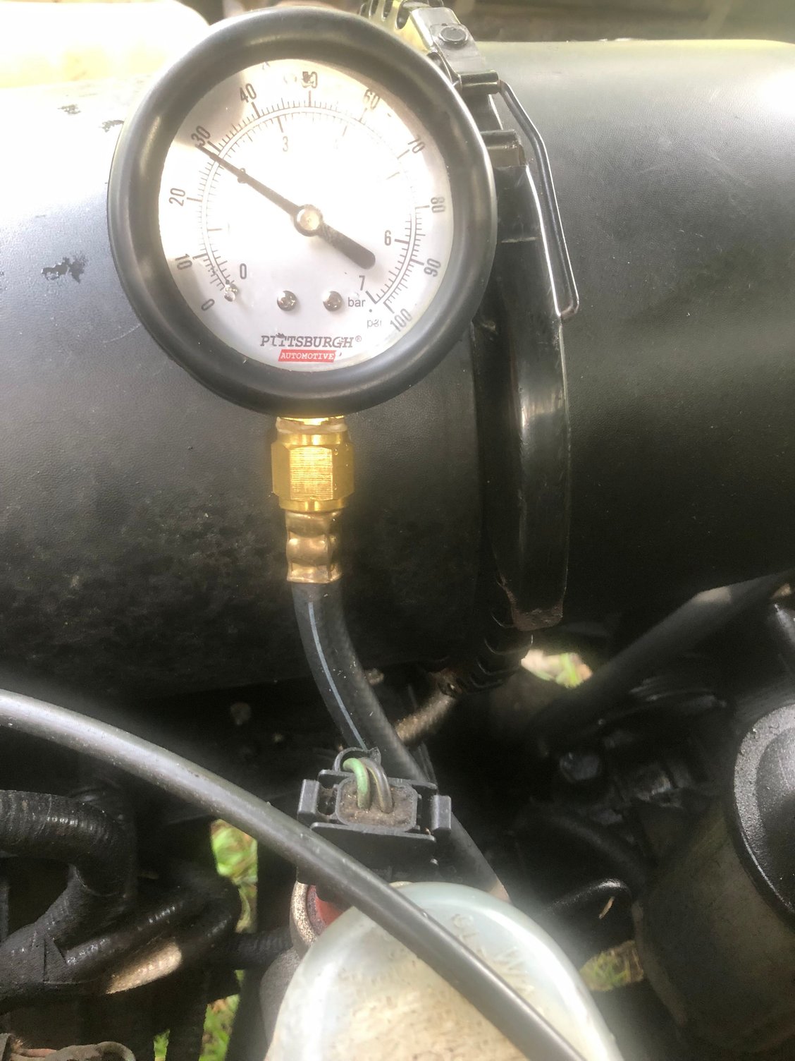

walked outside my gauge showed 0 until I turned key on. Maybe my harbor freight gauge is leaking I’m checking. I can’t find the regulator I believe I disconnect vacuum to egr valve

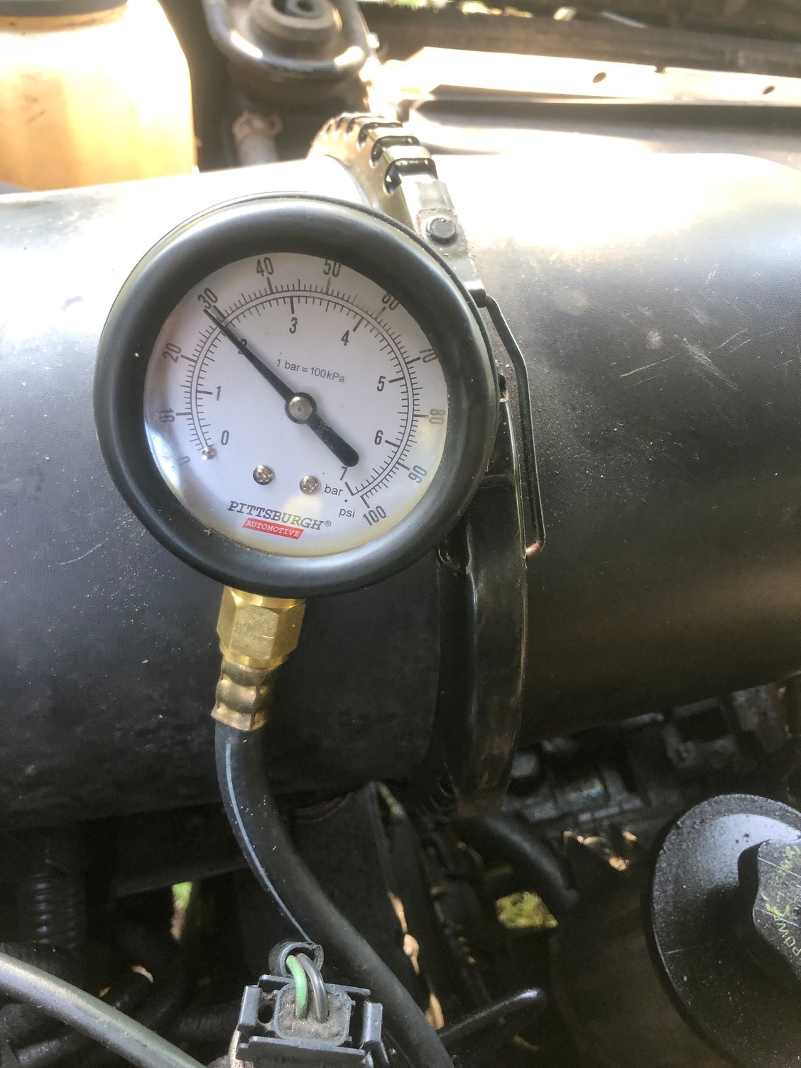

it runs about 30 psi
i believe it drops after a few hours of being off until I turn the key.

What is the fuel pressure with it running?
ok I read links
i installed new pump unit
I turn key it goes to about 30 psi
i believe a few hours later when I return it will be 0-10 psi until I turn the key on.
I haven’t confirmed the psi specs via google.

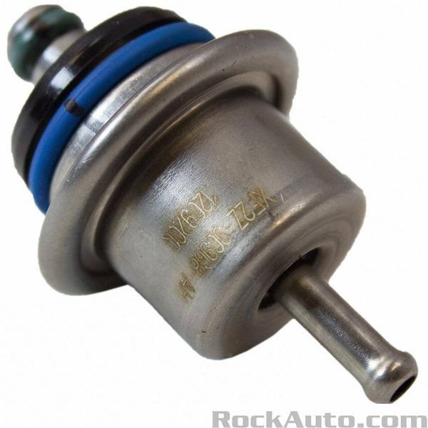

The FPR is on the fuel rail that sits on top of the injectors, pictured in post #14. You need to unplug the vacuum to see if it's operating properly. If it's leaking it's sucking gas through the vacuum line into the manifold, there will be gas in the vacuum line.
Specs are 28 to 40.
