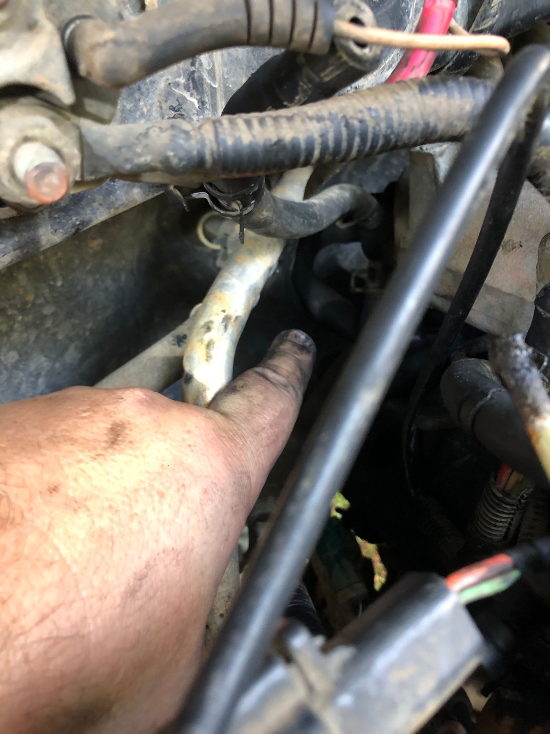

Finally today I tackled the project. Went to change pcv and discovered the infamous hose on very back was collapsed and when removed I could see holes and cracks.
Codes appear gone
also replaced battery

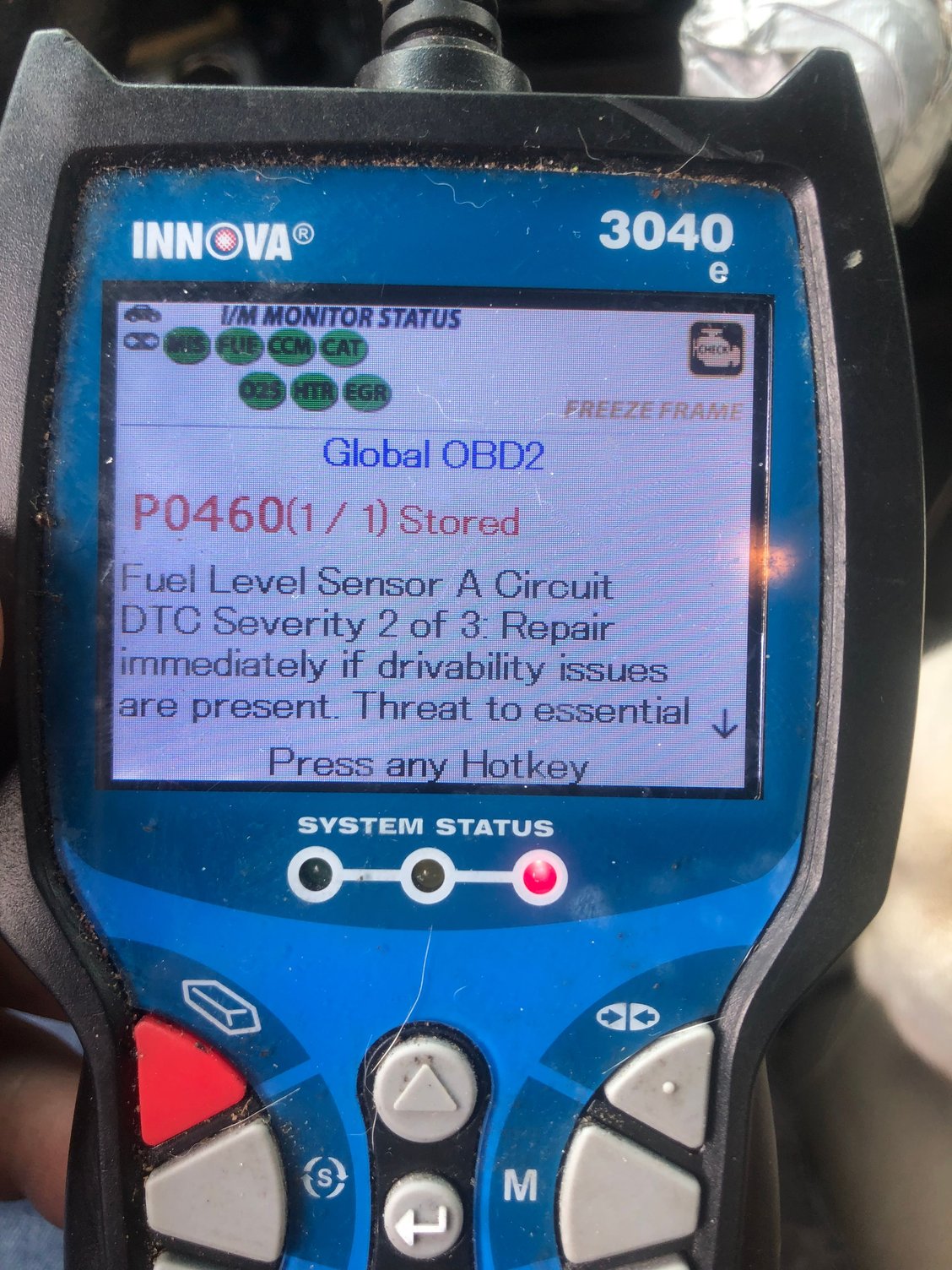

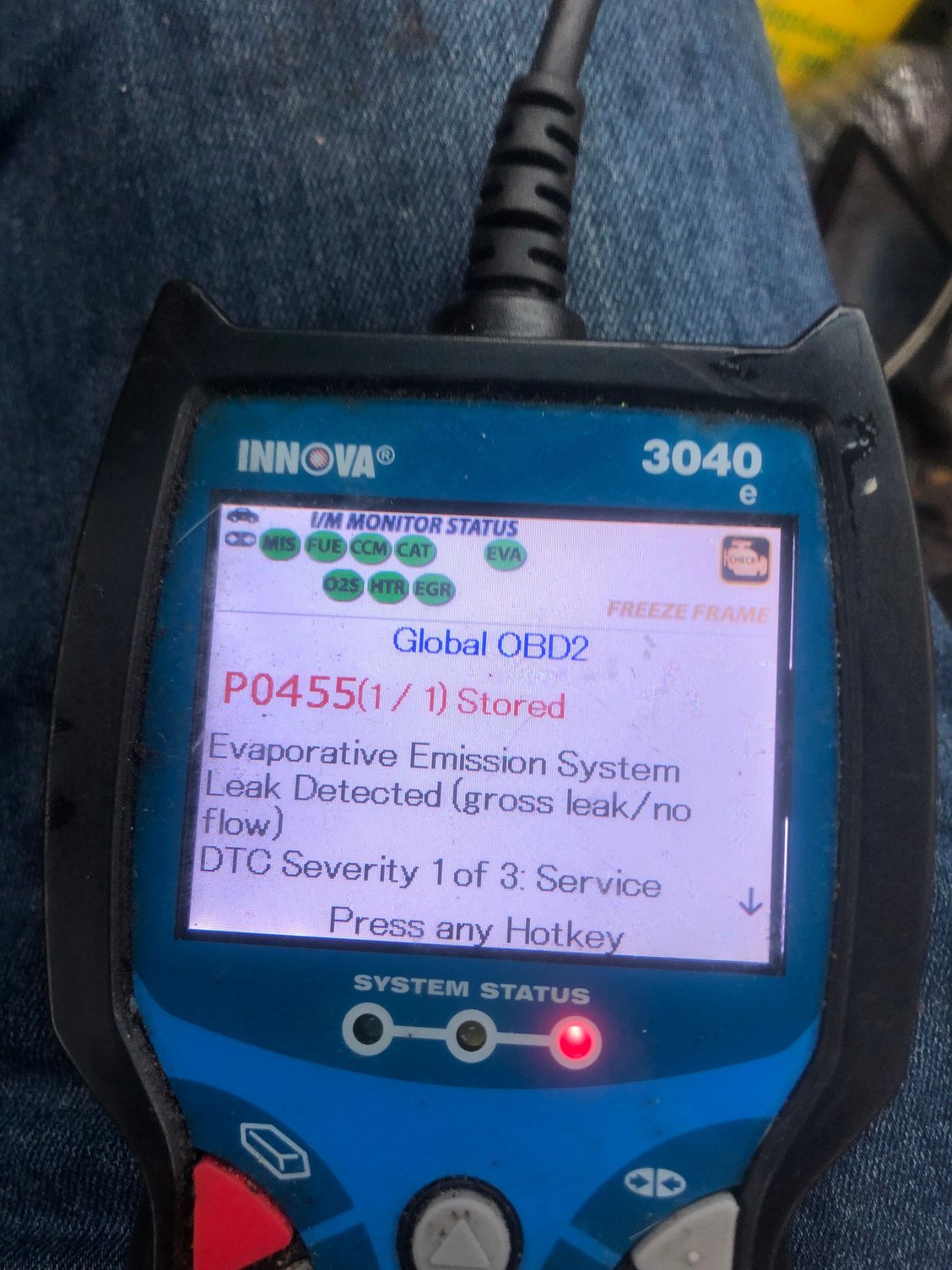

Today check engine returned for po455 the oil and water light came on and the temp gauge dropped to nothing even the 4 low light illuminated but engine died . It would start and immediately die. Then nothing. All I had with me was fuel pressure tester and code reader . Finally it started and I drove it home . Po460 code when I arrived home.
fuel pressure with engine off was 15-20 psi
2000 f150 4.2 4wd

Posts: 43,538
https://www.obd-codes.com/p0460
https://www.obd-codes.com/p0455
What is the fuel pressure with it running?
