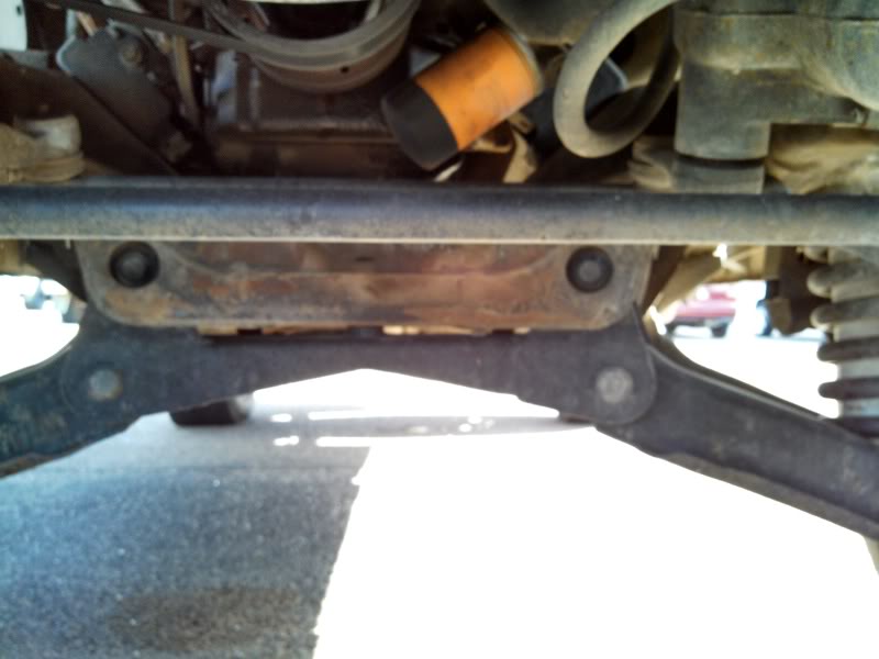

Is this a stock crossmember that the LCA's are bolted to?

Old May 3, 2013 | 11:15 AM
Rubicon35's Avatar
Posts: 172
From: Orlando
no that is not

Nope not oem, it kinda looks like the fabtech 7.5" crossmember.
http://www.trucktune.com/product/fab...FcJo4AodrwgALQ
Or better yet the procomp one:
http://www.procompusa.com/prodDetail...3533&plID=1808
And you said the front track width isn't wider than the back right?
Right, but I'm going to double check tonight when I get off work. Also, it doesn't appear to have any coil spacers. Seems like it is that Fabtech kit minus the spindles..
