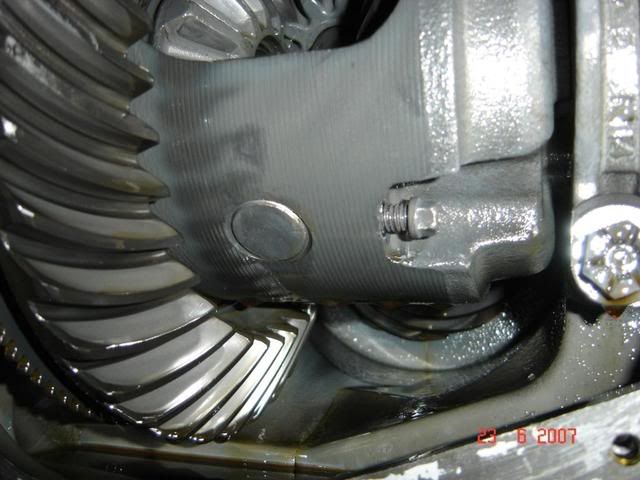

With the rear axle cover off, you're now gonna want to rotate the pinion flange around to get to the pinion shaft retaining bolt, as shown below:
This bolt is loctited in from the factory, so sometimes it can be kinda tough to get out. Hence why I recommended earlier to use a good six point socket or wrench on this bolt. It's a 3/8, and you may have to use a prybar wedged against the carrier/ring gear to get enough leverage to get it to break loose, like the picture below:
