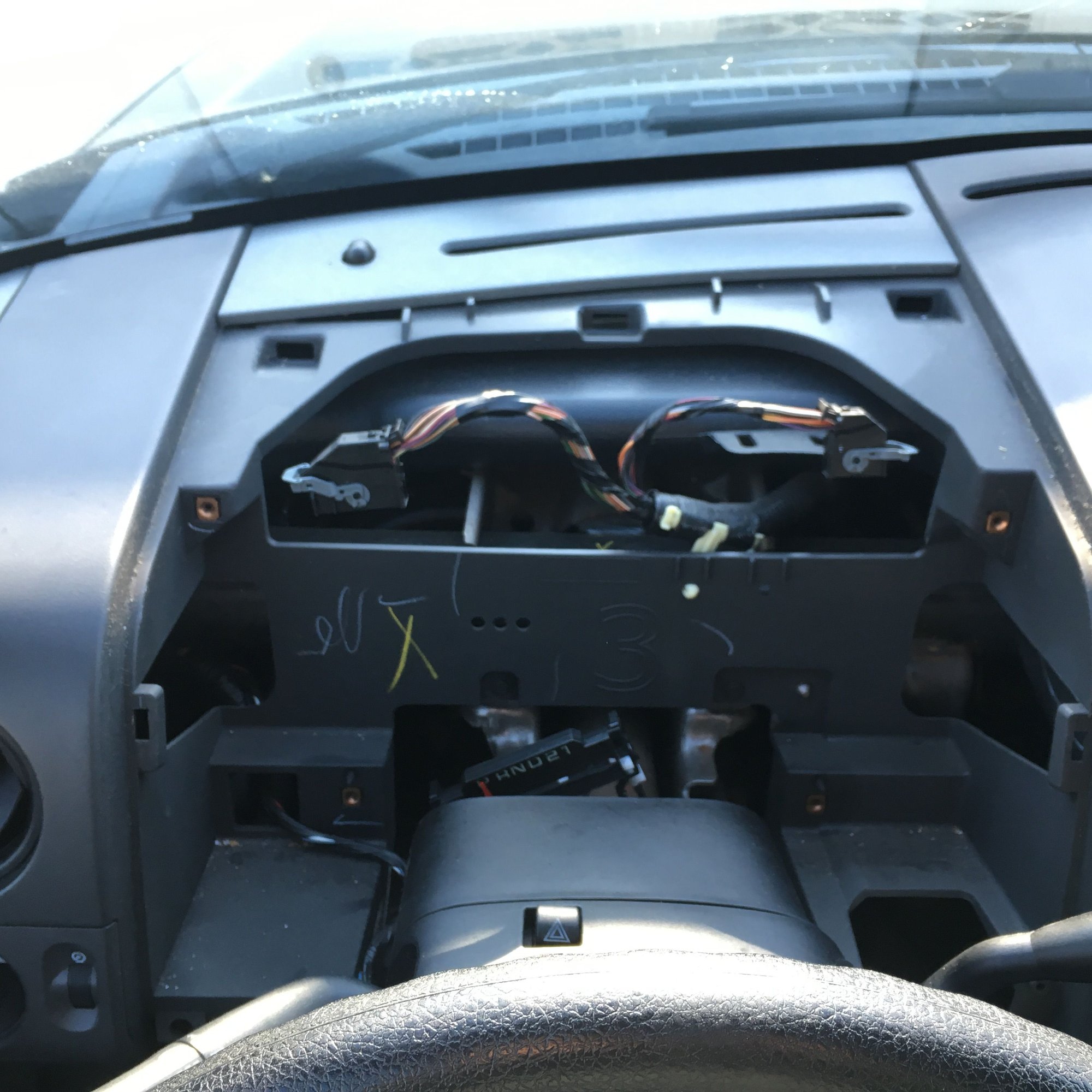

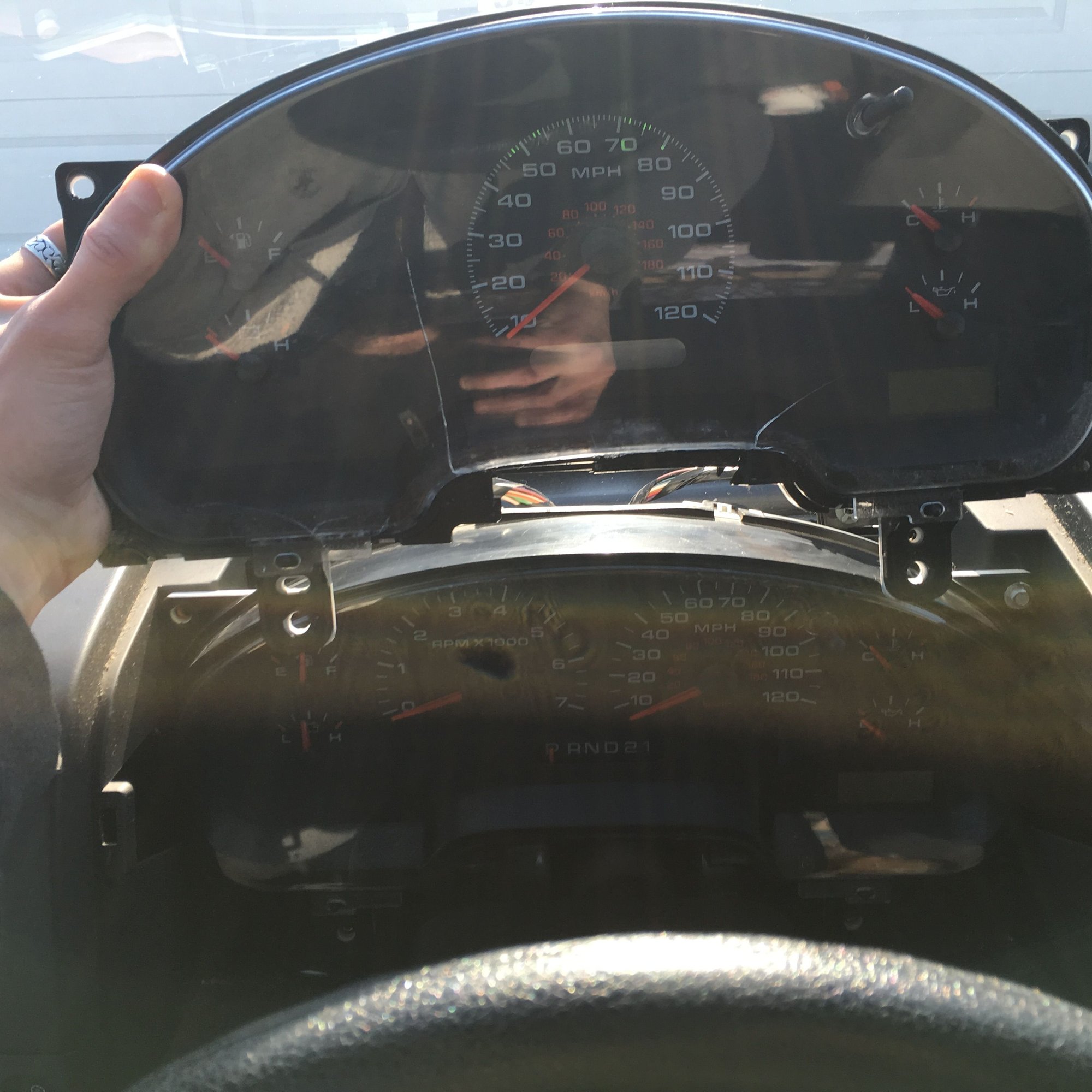

Picked up a used cluster from a wrecked F150... Mileage was only a few hundred off... perfect! It was plug and play. Only 2 things that don't work are the door ajar light / audible tone, and the new cluster has info for outside temp which my truck doesn't have the temp sensor.
Sorry for the crappy photos, Old on top, new installed.

It's plug n play in a sense, but definitely not fully plug n play. I only swapped clusters because I was messing around with my original one, broke a stepper motor and then damaged the board when trying to replace it. Wish I'd never touched it, ha.

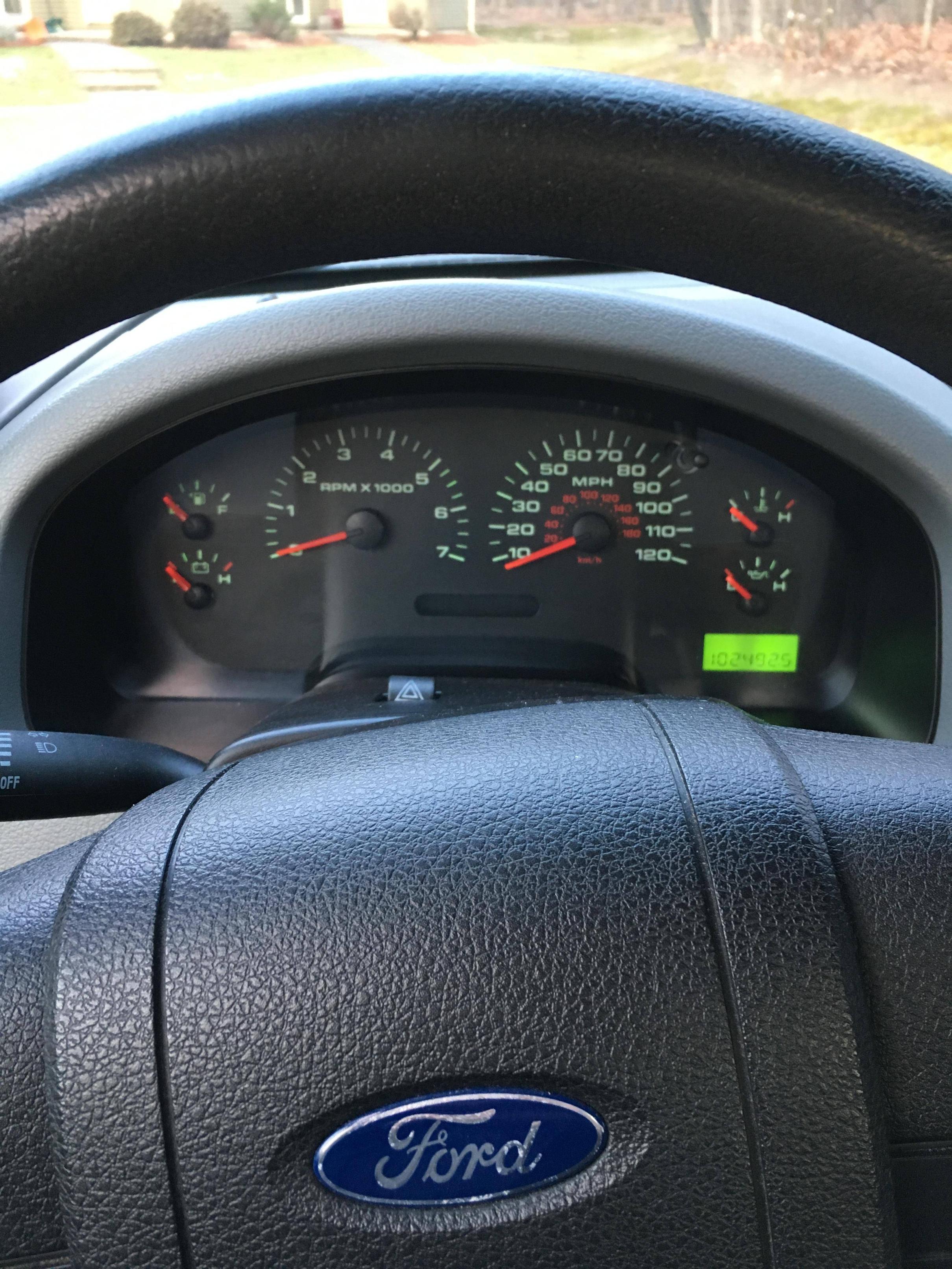

Original cluster:

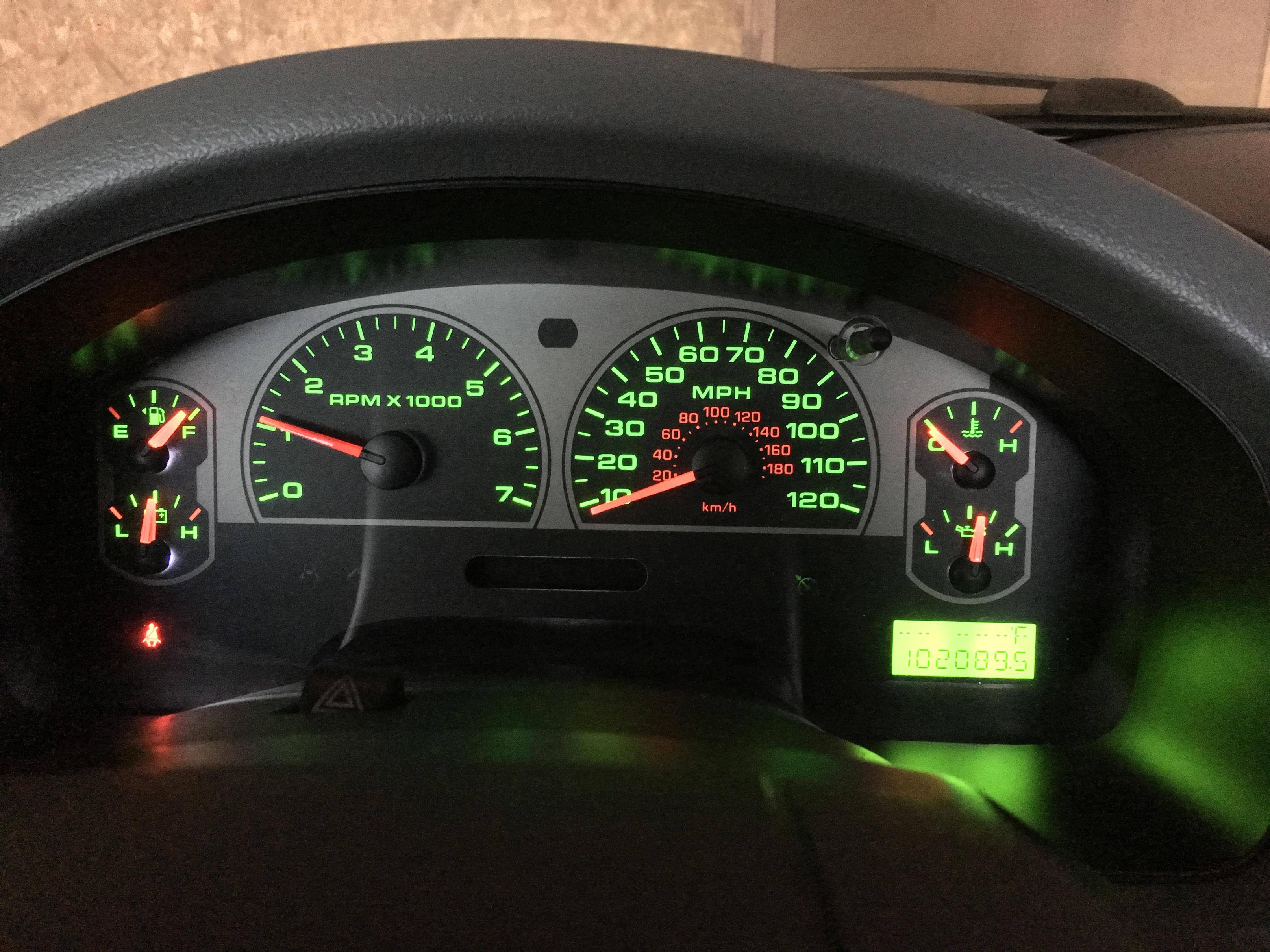

New xlt w/chrome package cluster: mileage was only different by 400mi.
