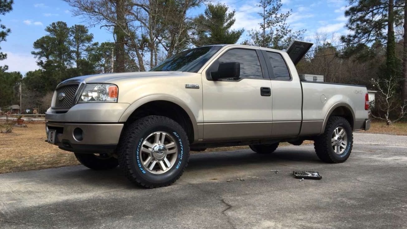

I have a 08 F-150 Super Crew cab 4x4. I was inquiring what would be the largest tire size than I can run on a stock 18" wheel with a 2.5" front leveling kit with minimal trimming? Thank you.

Here is my F150 w/ 275/70 18 and a RC 2.5" level
And here it is with my new BFGs, 305/65 18 w/ the same RC level. 305/65 translates to about a 33.5/12 18 I believe. No rub at all
