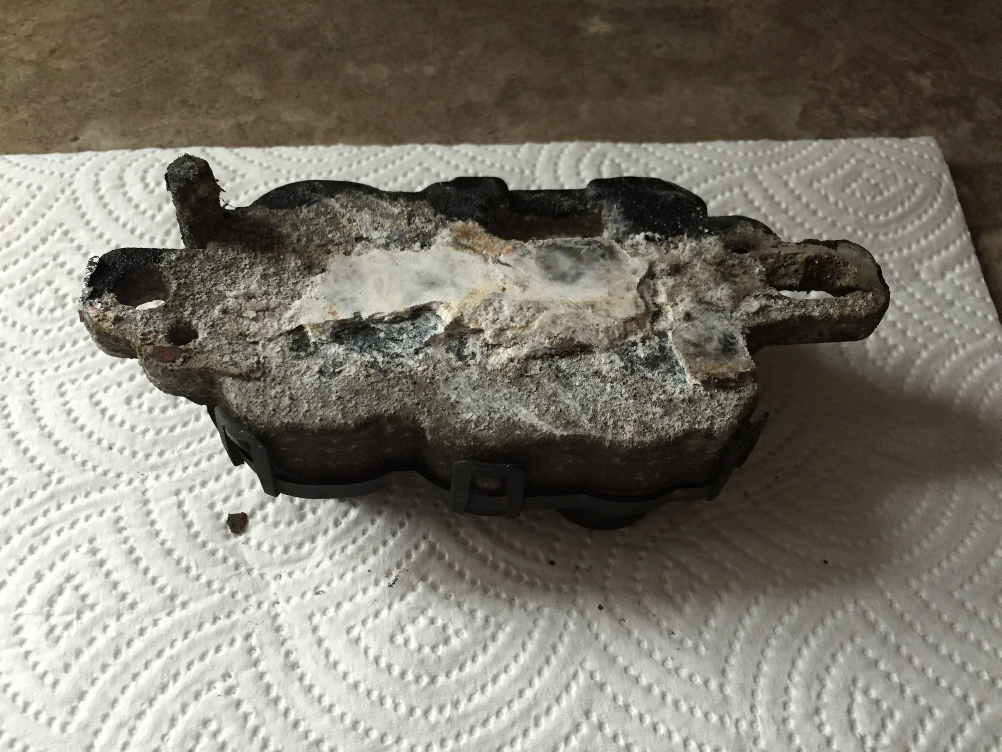

So I washed my truck yesterday and it ran great until this morning. Started it up let it run about 10 min. I put it in reverse and it absolutely had NO power off idle. After some cussing I pulled codes from my Edge P0191 and P1237. After some brief searching it pointed to the FPDM. So dropped the spare and found the problem. So my concern is I had to go to Advance Auto and buy a Dorman replacement. I would rather have Motorcraft but it's Sunday and I need my truck tomorrow. Advance does NOT accept returns if it's been used. Anyone have any bad experience with the Dorman? Truck seems to be running great again. The weather conditions couldn't be better for changing it 15 degrees and snowing

I think you fellas are right. Probably should just keep it. It's 100% obvious it has been mounted anyway. Who knows... maybe I can help a broke down friendly ford owner on one of our travels.
One other issue. I've put about 15 miles on it since I changed it and the idle seems lower then normal in drive. In park it's fine. I wonder if I should have disconnected the battery before I replaced it? (It was very cold and was in a hurry) I just cleared the codes was all.

Also ..... read the threads on FPDM and either use the Ford stand off kit of make up your own .... but get the FPDM up away from the frame rail.
