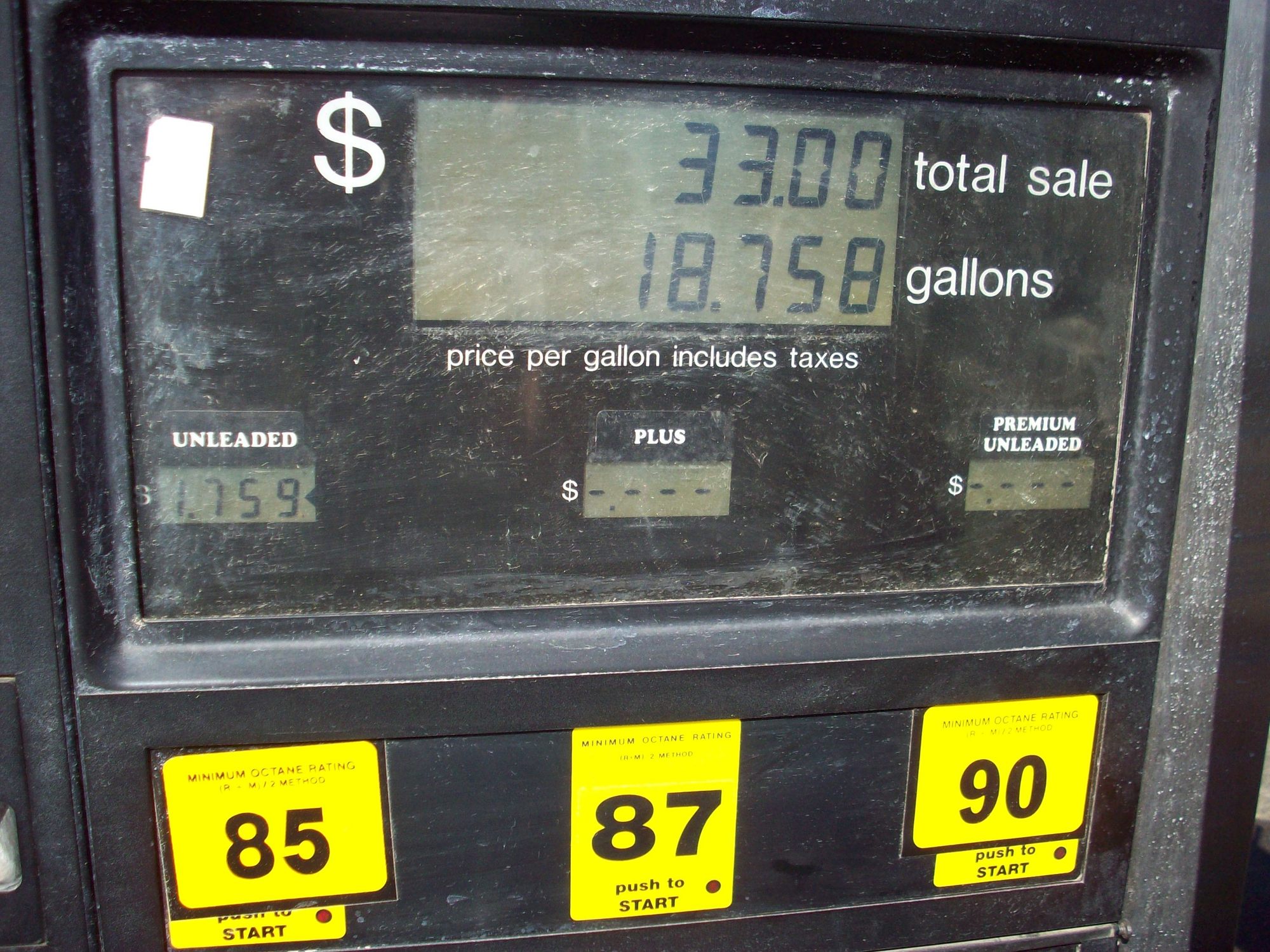

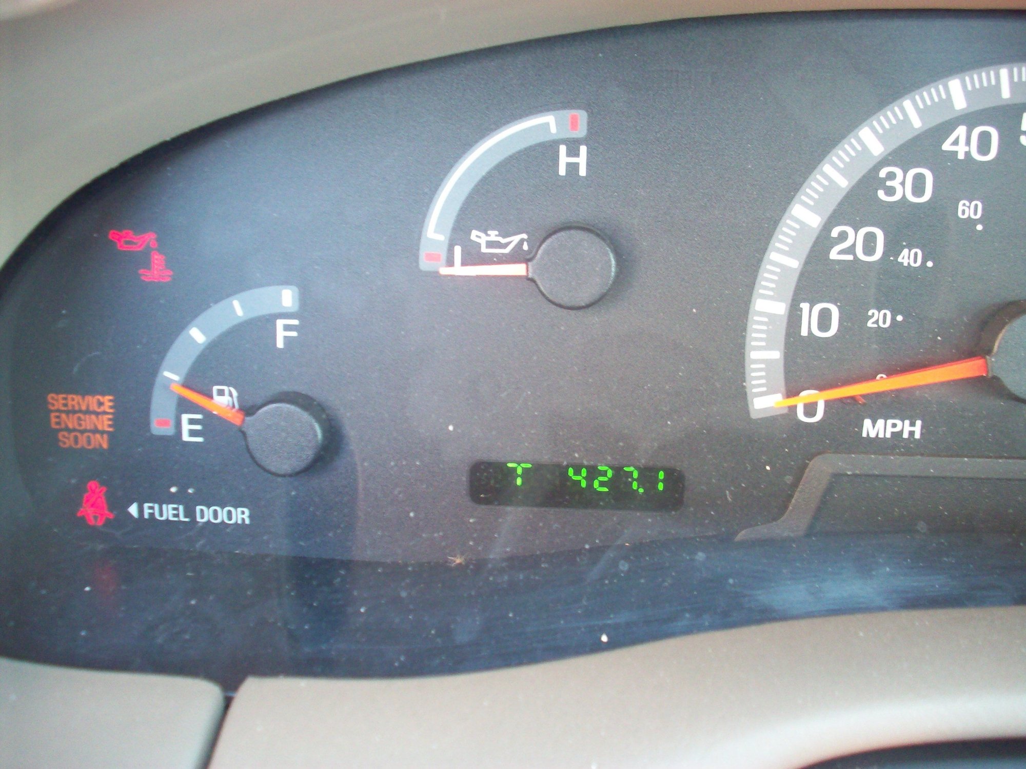

I know I'm in the wrong forum, but here's my best:
Yes, that's almost 23 mpg. 25 gallon tank.

$1.75 a gallon? This is what catches my eye... We're at $2.11 right now. Definitely makes it a little easier on the wallet.

That's awesome glc. That 85 is cheap. Currently on a trip to Florida and back, $1.89 is the best I've found.

That was a few years ago.

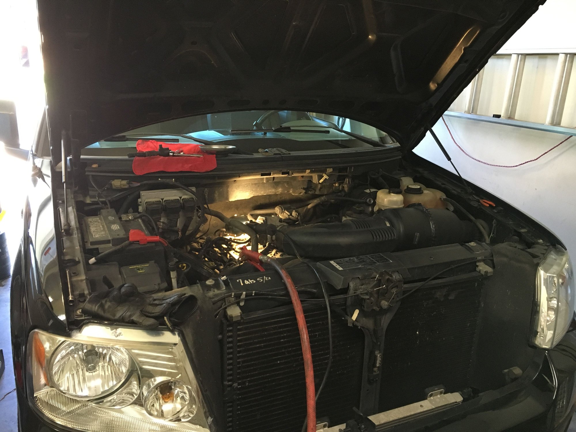

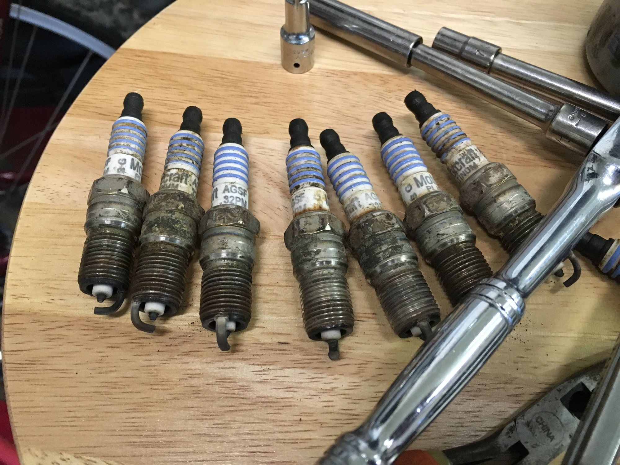

Way ahead of ya! Plugs didn't look TO bad... I implore everyone who is doing coil boots / plugs to use compressed air before taking the plugs out. There was so much crud in there, even with the boots keeping most of it out... If you don't blow out the spark plug wells, that crap is going to drop right into your combustion chambers!
