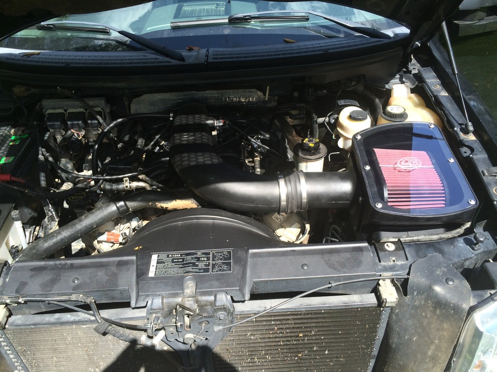

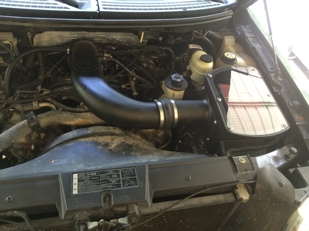

Well got bored today and installed a S&B CAI on our 2007 F150 FX4. Very nice piece.

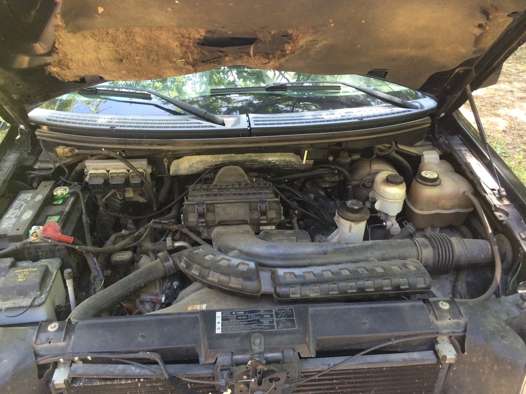

Before:

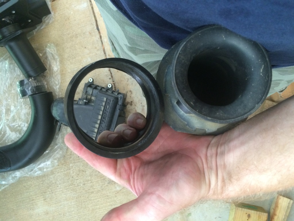

Comparison:
Intake piece through fender size comparison:

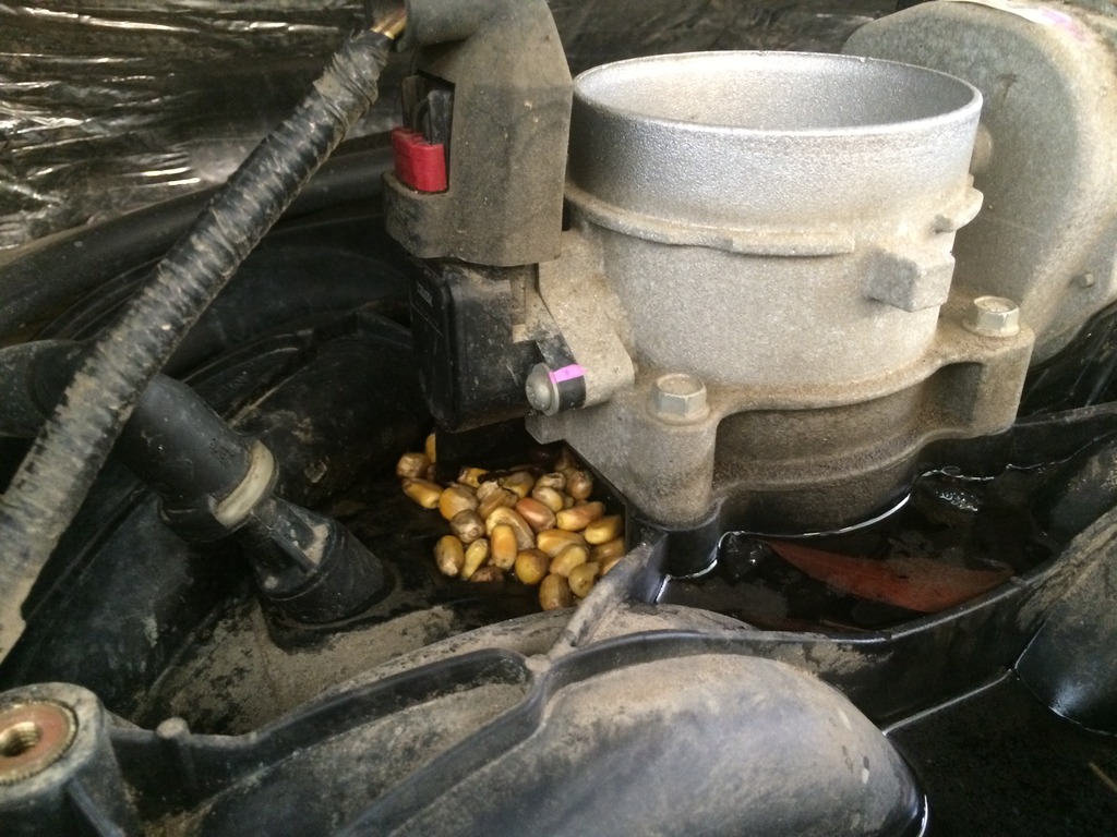

Found this when the intake was taken off. I guess we had visitors:

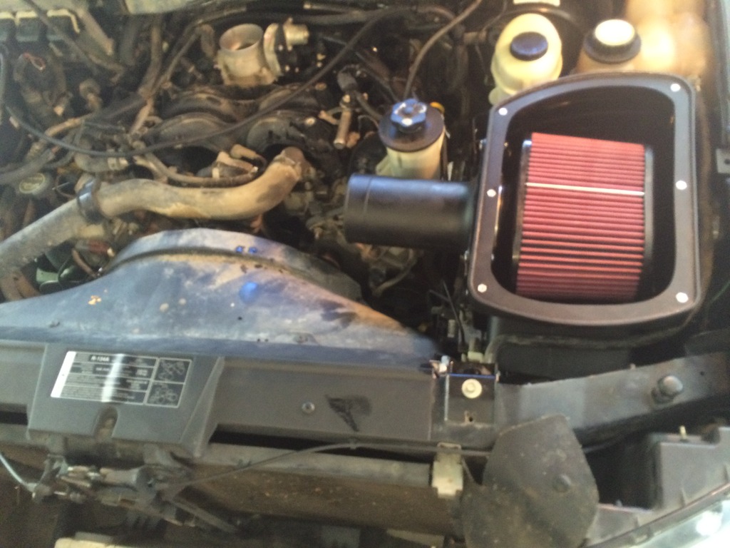

Install began:

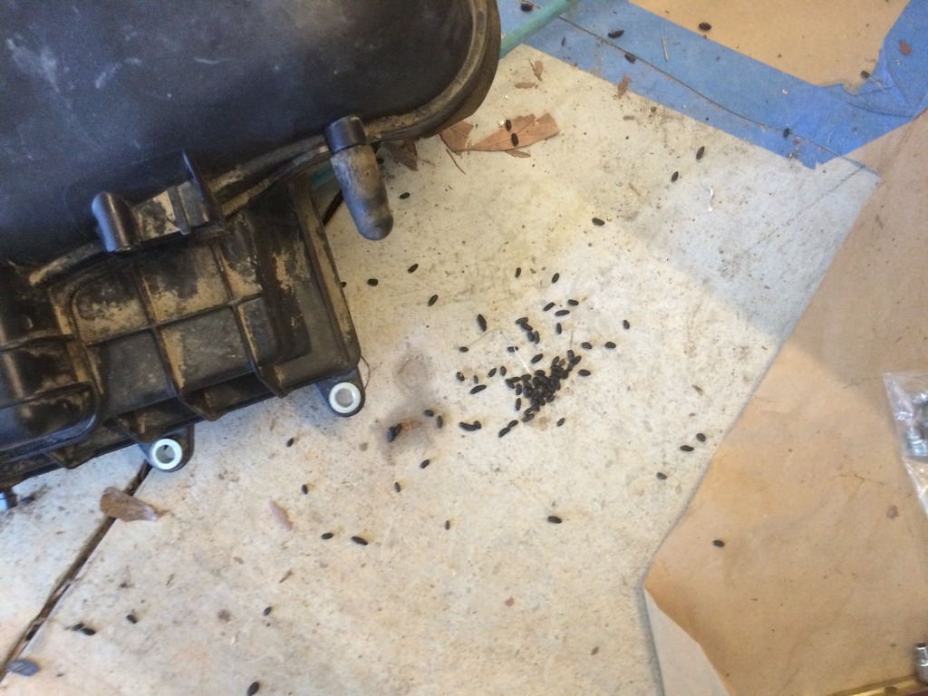

Poop fell out of the stock intake:

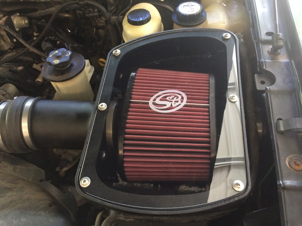

Installed:

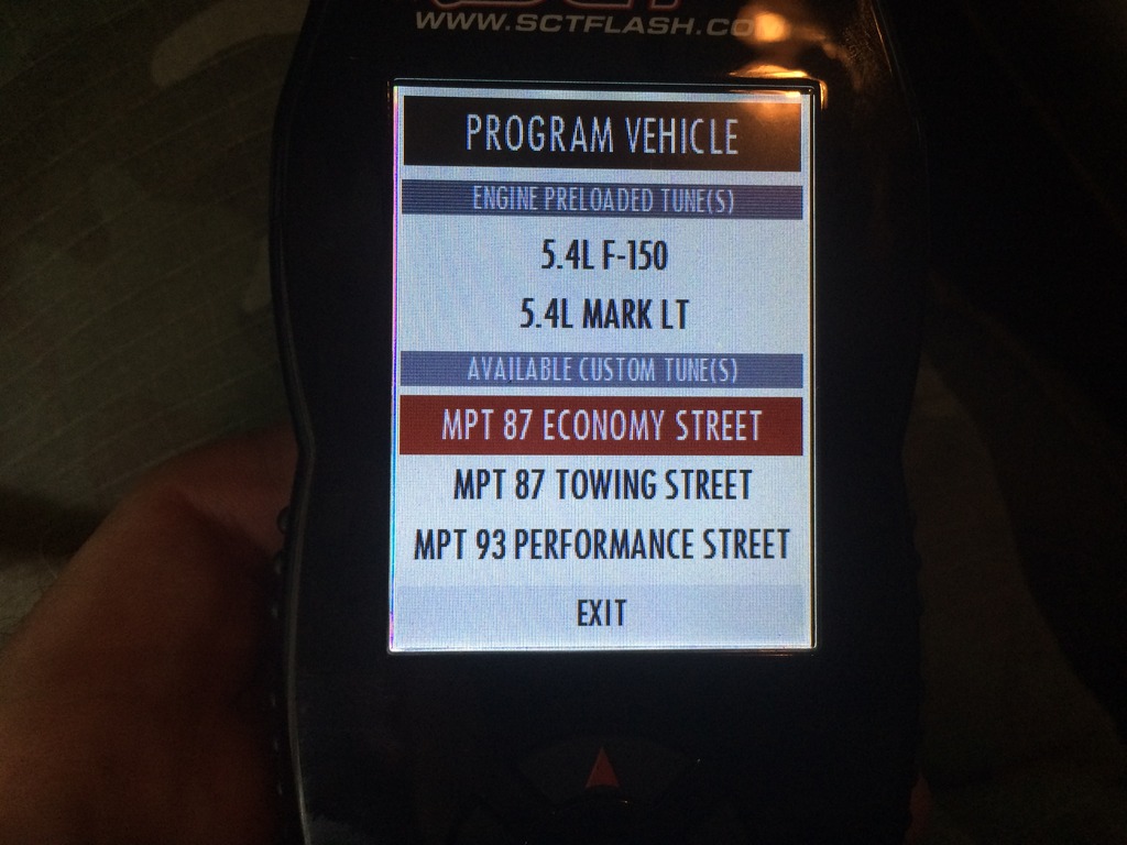

Loading a tune from MPT Performance:

Originally Posted by glc
Did you get custom tunes for that specific intake? If not, you are going to run too lean.
Picture #9 is loading a MPT Performance custom tune for this plus our other mods.
