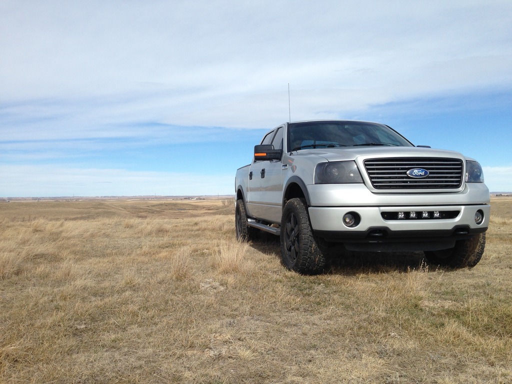

I'm running bilstiens on the 2" mark with 295/60/20.
No rubbing with stock offset rims and only slight rubbing on the front flaps with 1.5" bora wheel spacers.

is the new rubbing you have on the front flap able to be handled with some trimming? Ive been thinking of either 295/60s or 285/65s with 1.75 spacers (so I don't have to cut factory bolts)

They rub because the flaps are about 1/2" thick. But it's really only at full lock. I could probably trim the flap, or mount it under the fender to fix the rubbing issue. 285's wouldn't rub as bad I don't believe.
