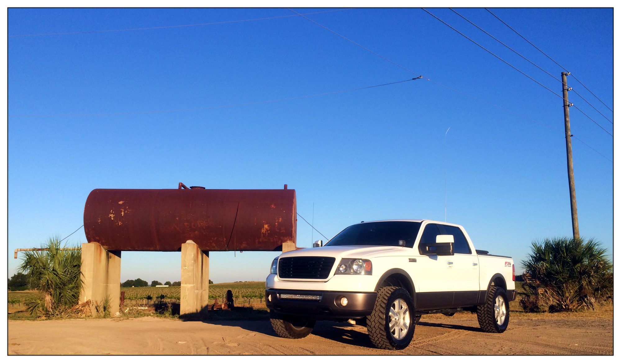

I'm running 295/65/20 on stock rims with a 2" level. Rubs very minor on the upper control arms. Really only enough to scuff the dirt off. Mind you I don't ever hit full lock when steering anyways.

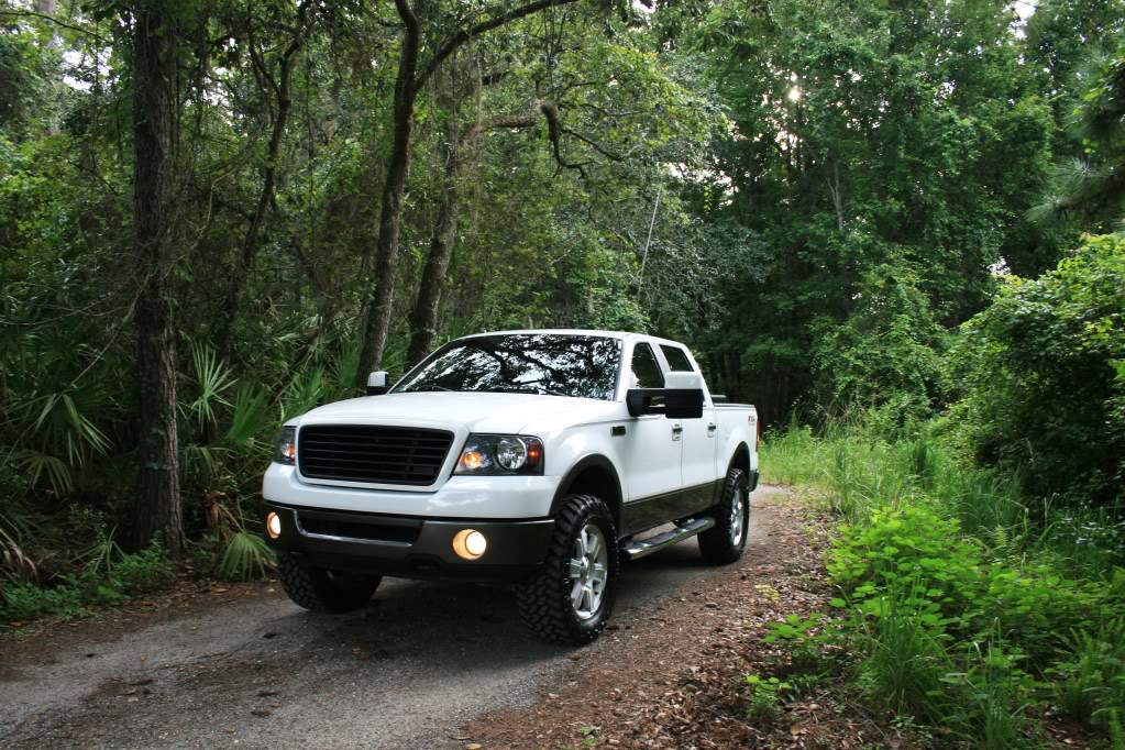

I have 295/60R20 Nitto Trails and I had to run a 1/4" Spacer to clear the upper control arm like he said. I now have 2" Bora Wheel Adapters and I had to trim some of the plastic fender, but that is is. Pictures below and links to threads.
1/4" https://www.f150online.com/forums/wh...-oem-20-s.html
w/ 2" https://www.f150online.com/forums/20...installed.html
-Curtis-
