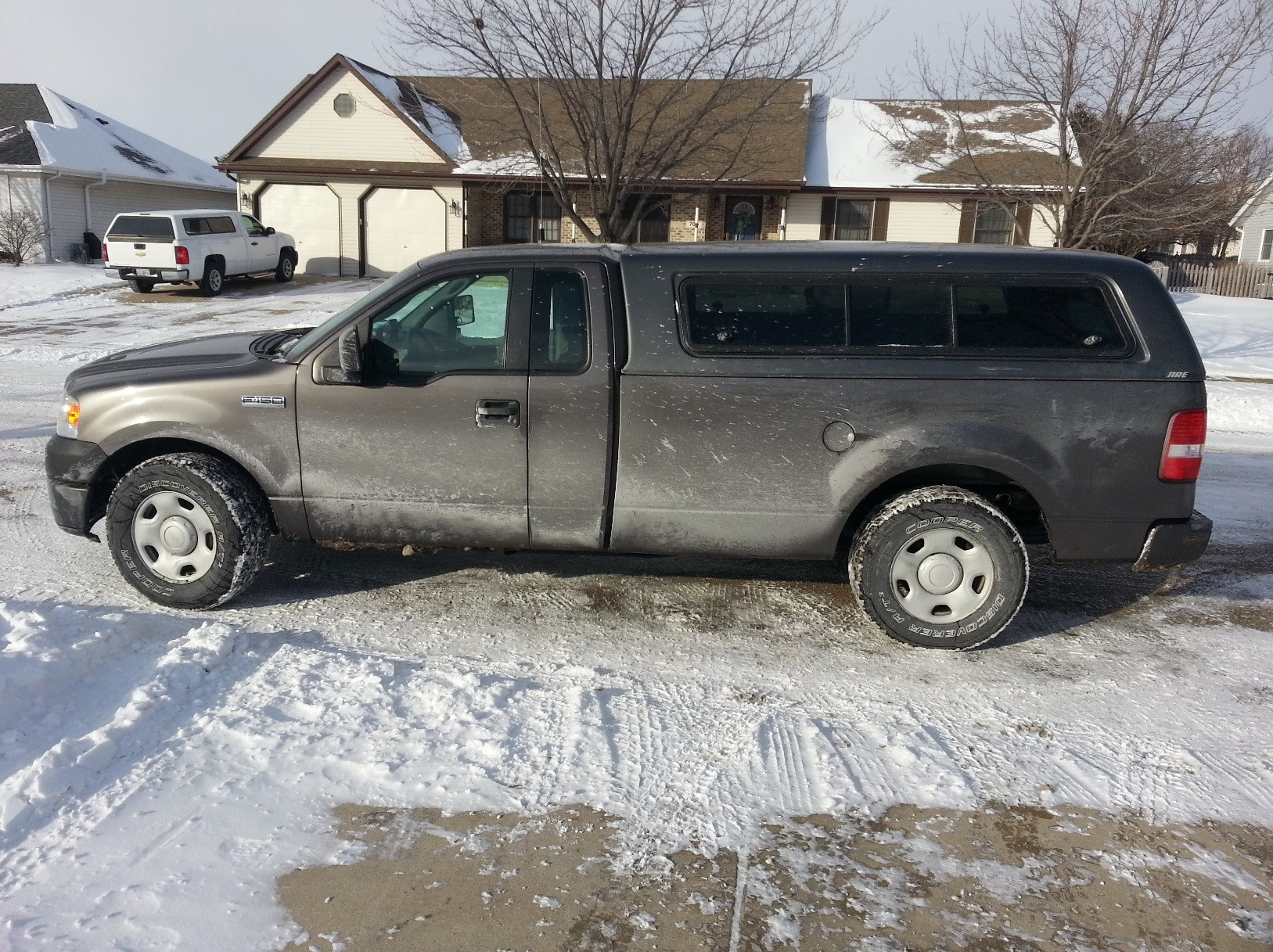

Did you lift or level your truck when you added those tires? Not that you needed to, just curious how it looks. Have a pic?
I have the same sized tires, but with 3" rear blocks and 4x4 lenth coilovers lifting the front 1.5-2"
I have 3.55s in my truck and didn't notice any difference in acceleration from the smaller tires that were on there before. I can't imagine 3.31s and 3.55s would really act that differently.

Just took this before i went to the store, i'm standing on the driveway so it prolly looks a bit lower than it really is. Also that is a 2m/440cm antenna on the roof.
(cooper at3's, wooh!)
yeah, no lift or anything. Well besides the whole acceleration thing it would make the speedometer almost correct again
