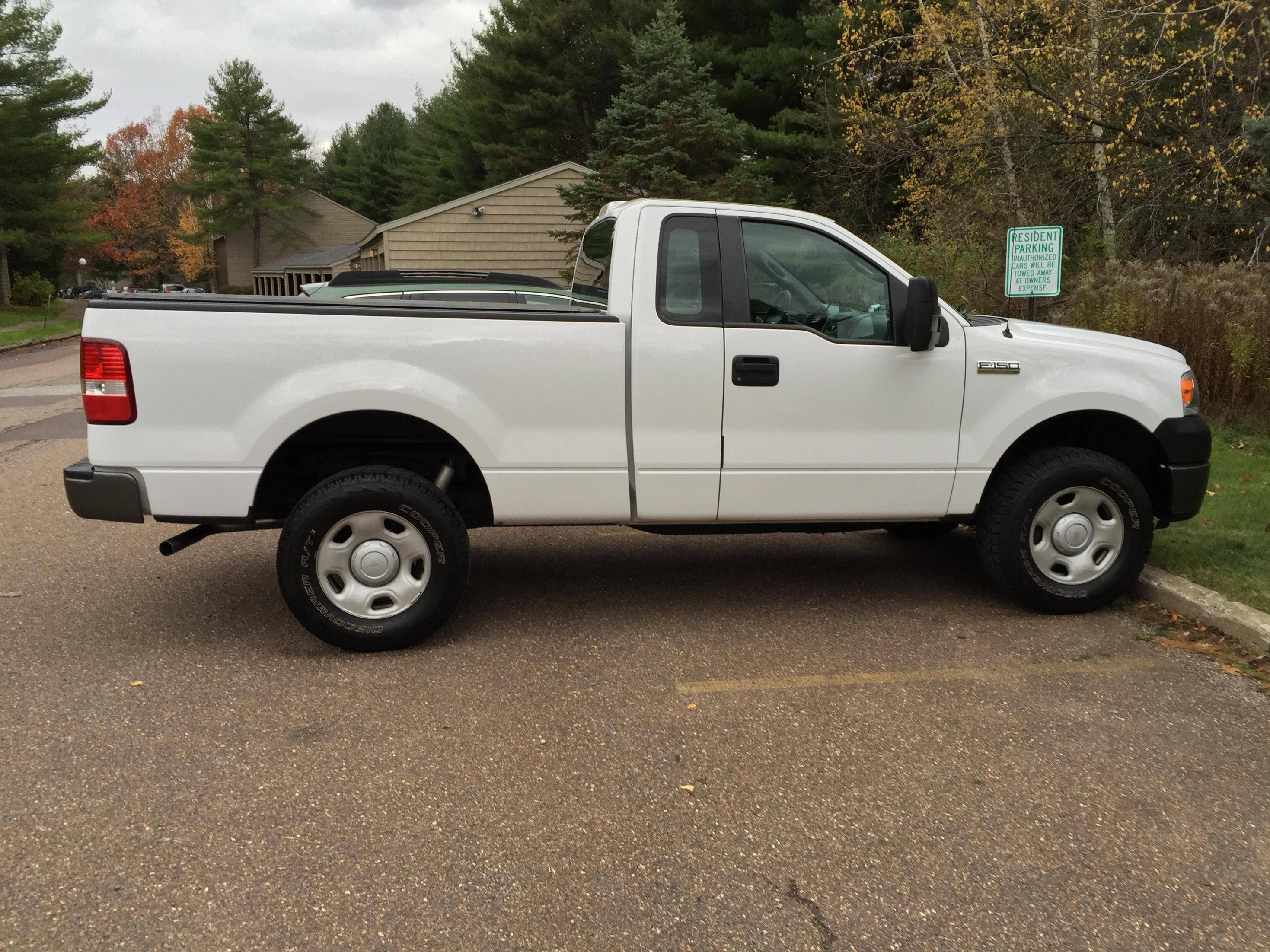

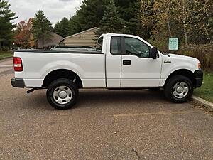

Just took this before i went to the store, i'm standing on the driveway so it prolly looks a bit lower than it really is. Also that is a 2m/440cm antenna on the roof.

yeah, no lift or anything. Well besides the whole acceleration thing it would make the speedometer almost correct again
