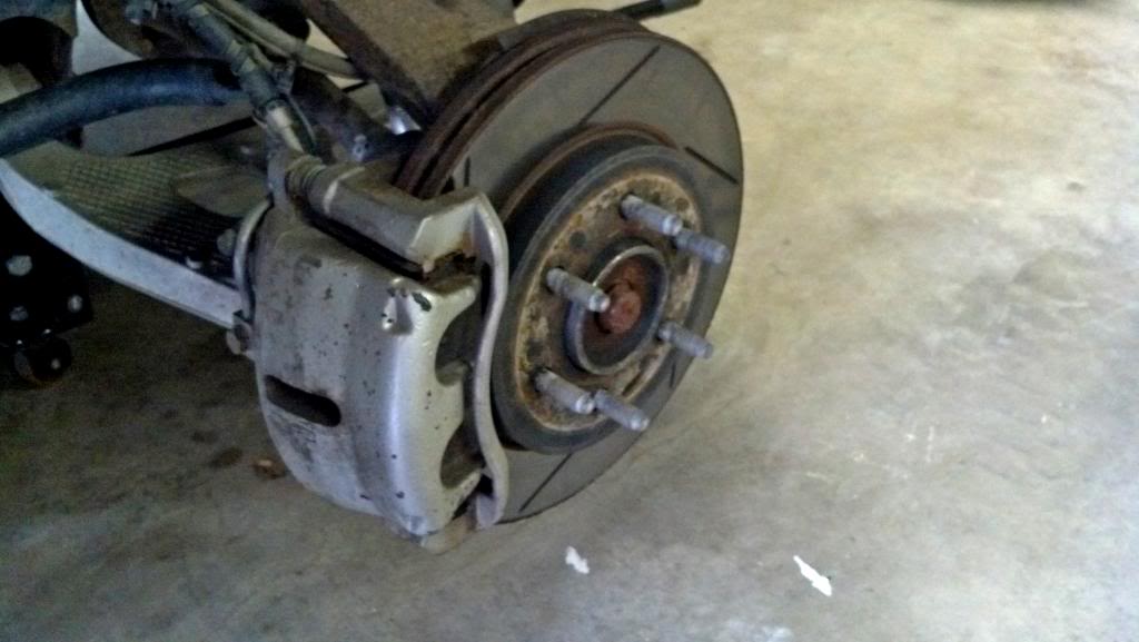

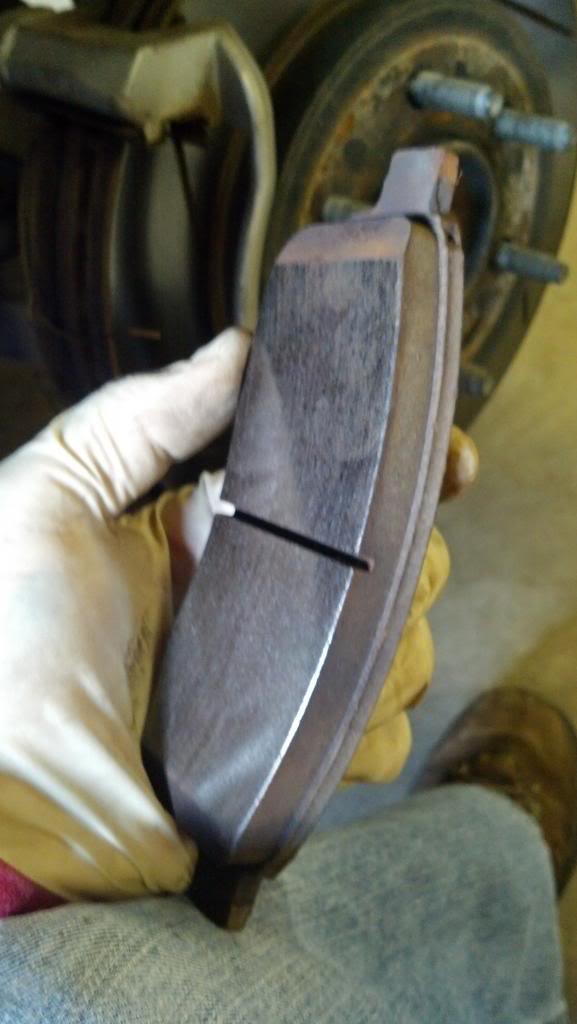

Same here, Powerslot slotted disks, hawk LTS pads, awesome braking with little to no dust, installed since 2011. Just took front brakes apart to grease and check things out, hardly any wear on the pads at all. I don't expect to have to change them for years.
Heres a couple photos of my brakes from my tear down after 2yrs/40k miles of use.
