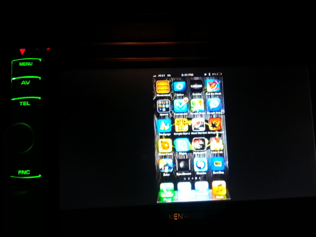

so i figured out how to mirror everything on my iPhone on to my aftermarket Head Unit. I don't know if anyone has done this, if so sorry for the re-post. Anyways everything i do on my iPhone 5 shows up on my screen. I did this mostly to get videos from my phone on to my stereo.Name:  20130301_204305.jpg
here is a quick video i took on how it all works.
http://s1214.beta.photobucket.com/us...84230.mp4.html
what im working on now is routing all the wires and cleaning up the mess

That is badass!! What kind of head unit?

its a kenwood DDX419 but this will work with any head unit with an AV in input

looks cool, could you post up what you used.
Im assuming this would work on any phone with an HDMI output and any headunit with an AV input?
Old Mar 30, 2013 | 03:25 AM
Very interesting. As stated please let us know the parts needed for this.

i used an HDMI to RCA Adapter. You have to use the adapter because you are going from an analog to a digital signal(or other way around) $30 on amazon
RCA to RCA $5
Apple HDMI to Lightning adapter $30
hdmi cable $8
as far as i know it should work with any phone that is Hdmi capable.
