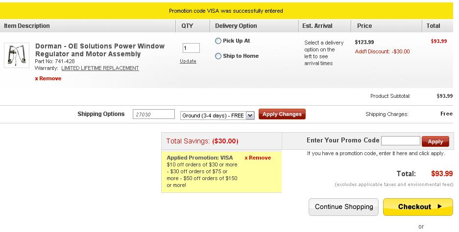

I just replaced my passenger side. I paid 93.99 for my Dorman at Advance. I found it on their site, put the code Visa in at check out for a nice $30 discount and then went and picked up in store. Its the same as going in and buying but you get a nice discount.. The dorman ones are great quality, better than OEM. I personally recommend it instead of some other brand that may not last.
