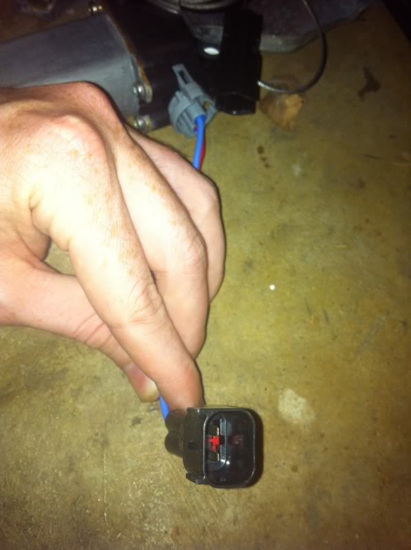

Just went and looked at my old stock one. It has the rectangular-ish connector with about 4" or so of wiring coming out of the motor. The Dorman replacement I put in was identical to that. Here's a picture of my stock one:
So, are you saying that your stock plug is round instead?

If u unplug it at the regulator motor, it is round there. I did same thing not long ago on 05. Thought I had the wrong part, but just unplugged it at the wrong place.

Oh yeah! That's it. If you look at my picture, you can see how it connects down at the motor at a round connector. Unplug it at the plug I have a picture of. If you unconnect it at the motor itself, it can be pretty difficult to get it plugged back in.
