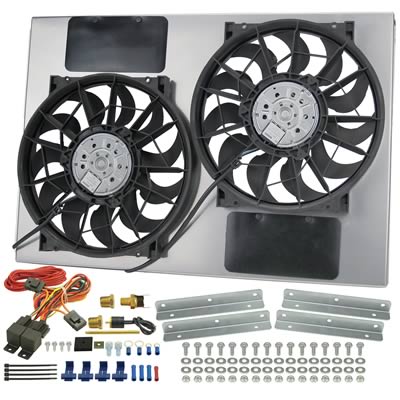

Originally Posted by Fifty150
I have the Troyer set. Derale also makes a set of fans that is engineered to drop into the F-150.
I think he means Flex-a-Lite. I too have the Troyer fans and the components are made by Derale. There's no shortage of threads in the "Other Aftermarket" forum on this site with all sorts of different options, including controllers. The 2010 - up F-150 comes with electric fans that seem to bolt up to the 04-08 models, but you still need a means to control them. That's the route I would pursue if I was going to do it over again.
Old Dec 8, 2010 | 06:07 PM
Fifty150's Avatar
Joined: Sep 2007
Posts: 3,688
From: The Barbary Coast
Nope. I mean Derale. As in the Derale 16027.
Old Dec 8, 2010 | 06:08 PM
Fifty150's Avatar
Joined: Sep 2007
Posts: 3,688
The Troyer kit offers 5500 CFM, as opposed to the Derale 4000 CFM.
