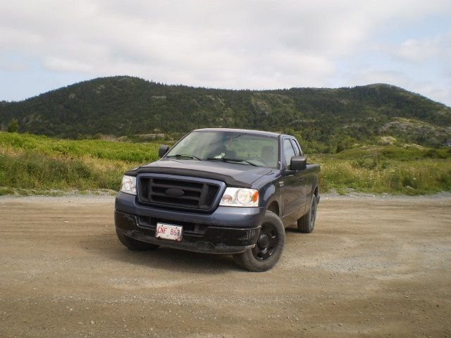

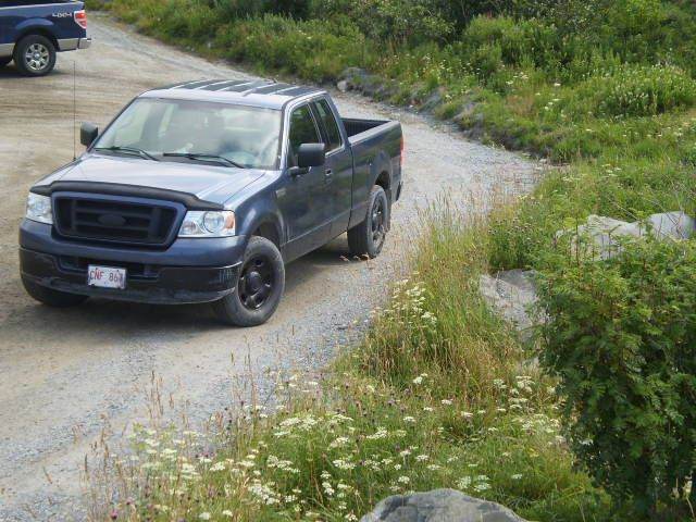

Dang, that's the first one with the 8' bed I've seen that low. Any more pics?
That's a short bed..
It's actually the 6.5 foot bed!

Dang...the angle made it look a lot longer. nvrmnd, no pics thanks

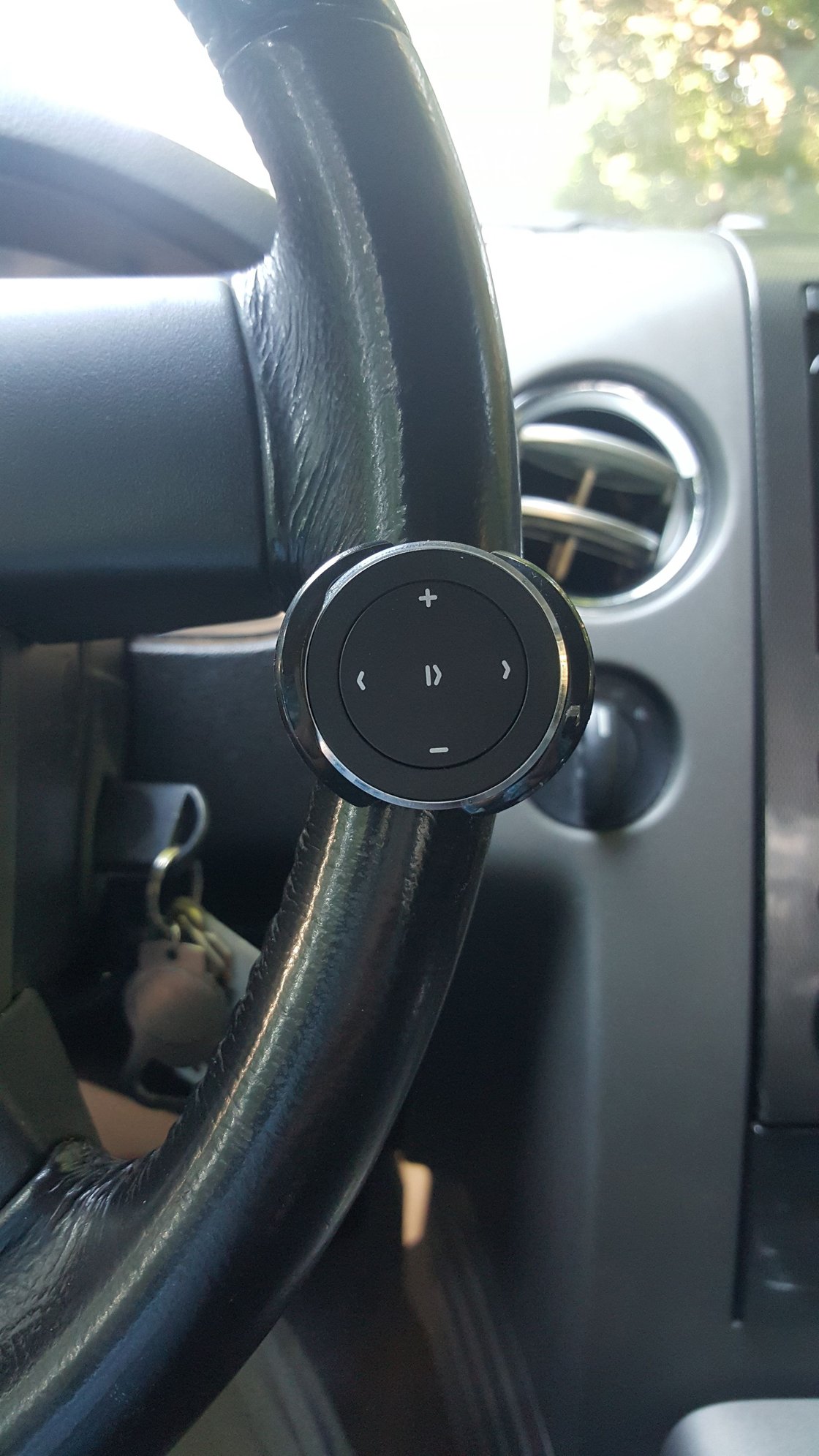

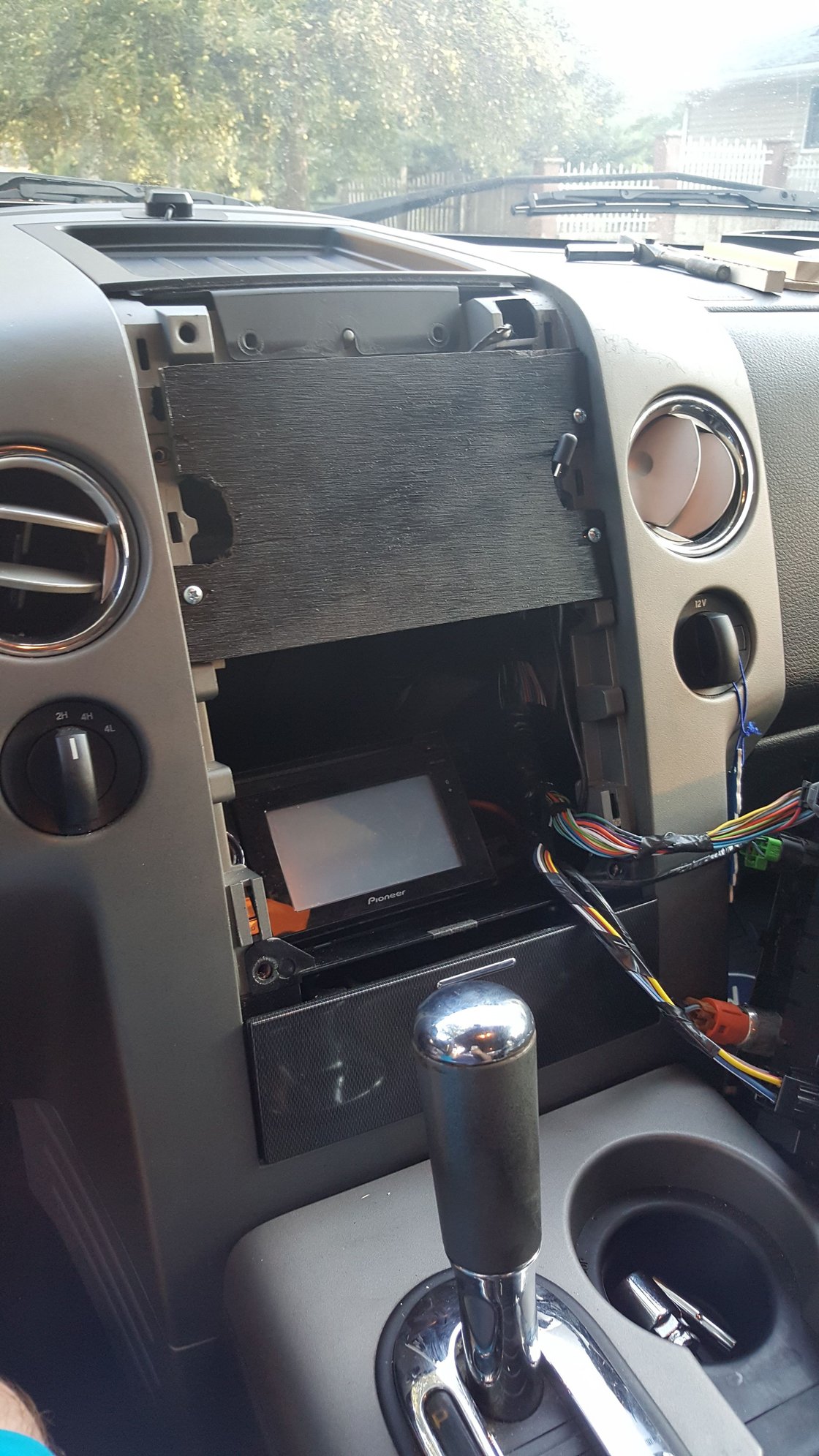

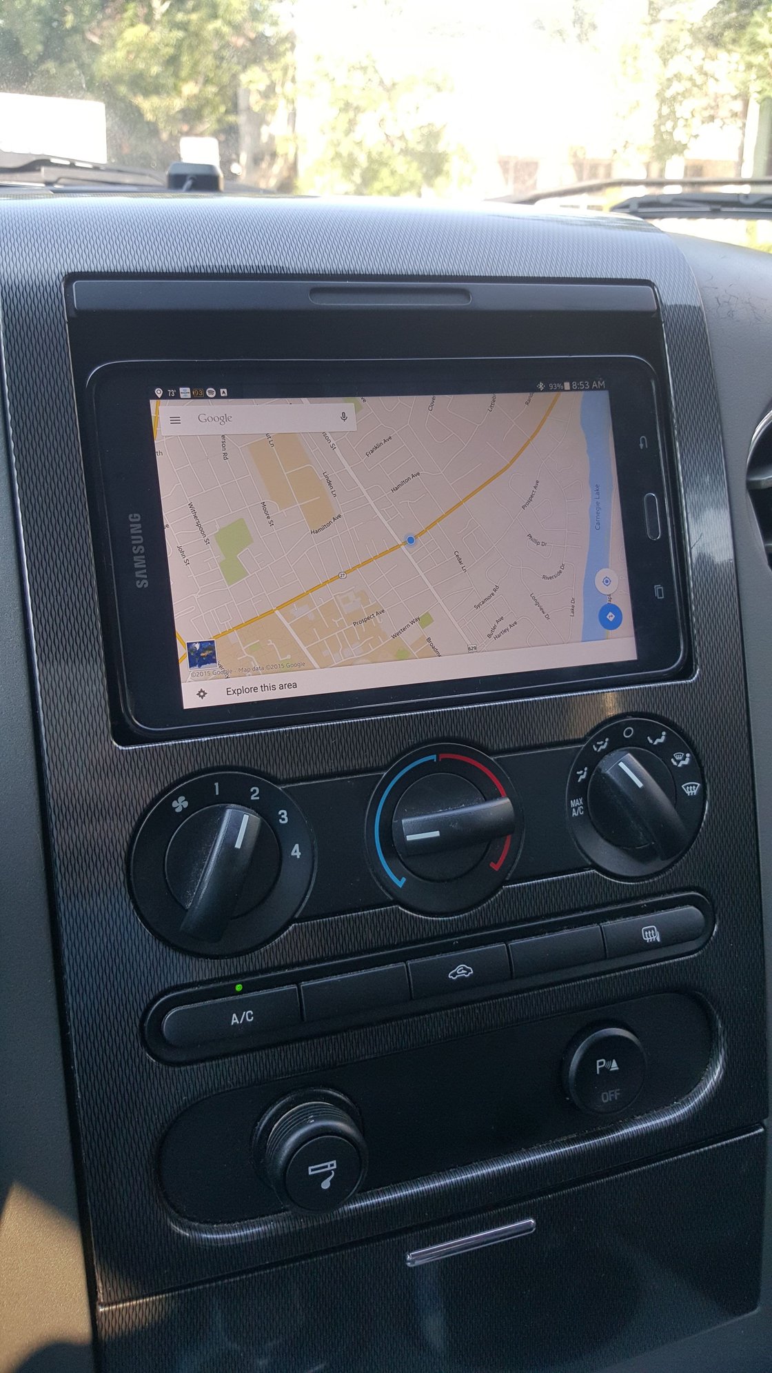

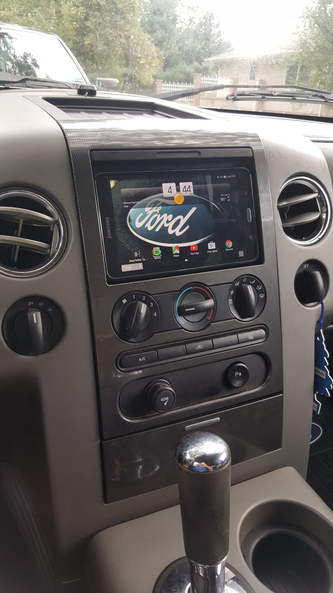

What I did today:
I have had a Pioneer aftermarket head unit for a few years. The unit has become out of date, unable to connect to my phone (Galaxy S6) through Bluetooth. I looked into doing Pioneer's Android Auto head unit but the cost didn't seem worth it to me as the unit was limited.
After much research I decided to install a Galaxy Tab 4 (7 Inch) in place of my head unit. Most 7 inch tablets fit great in a double din. There are many ways to do it but I decided to keep my Pioneer head unit in the back powering the tablet through AUX. I found later that older devices do not have digital audio converters built in so I decided to run a bluetooth adapter that plugs in the AUX of the head unit. This ended up saving me the headache of running an AUX cord (Bluetooth doesnt distort like an AUX cord would). I had some trouble running the power but i was able to drill out a section for it. The Satechi Bluetooth Media Button is the key to the setup. The button comes with a wheel attachment and I am able to change songs and adjust volume through the device. I can bluetooth tether internet connection to my phone to the tablet
Apps I Use:
-Spotify (Download playlists for use w/o internet)
-Serious XM
-TuneIn Radio
-Google Maps (Able to download 25 miles radius for use w/o internet)
-Auto Sleeper Auto Power ON-OFF (Goes into sleep when power is not detected, wakes up when power is detected)
Apps I Am Working On
-Torque
-SDR Touch (Physical USB Radio Antenna for use w/o internet)

Wow, that tablet in the dash looks awesome, adds a ton of functionality too.
If you get a MiFi hotspot in your truck, you could do EVERYTHING in there.

Yea something I'm considering

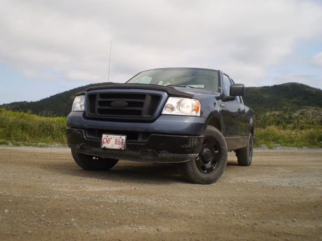

PTM surround

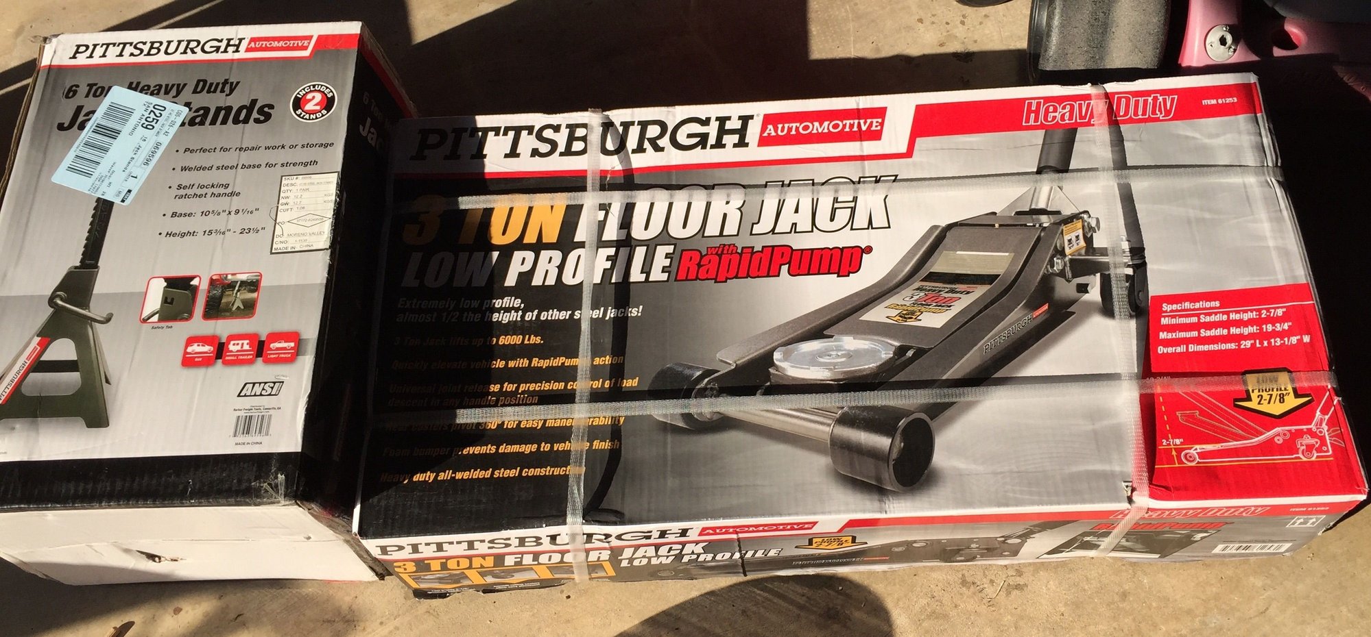

I got a new jack and stands. 3ton jack and 6 ton stands. I only had a 1.5 jack and 3 ton stands.
