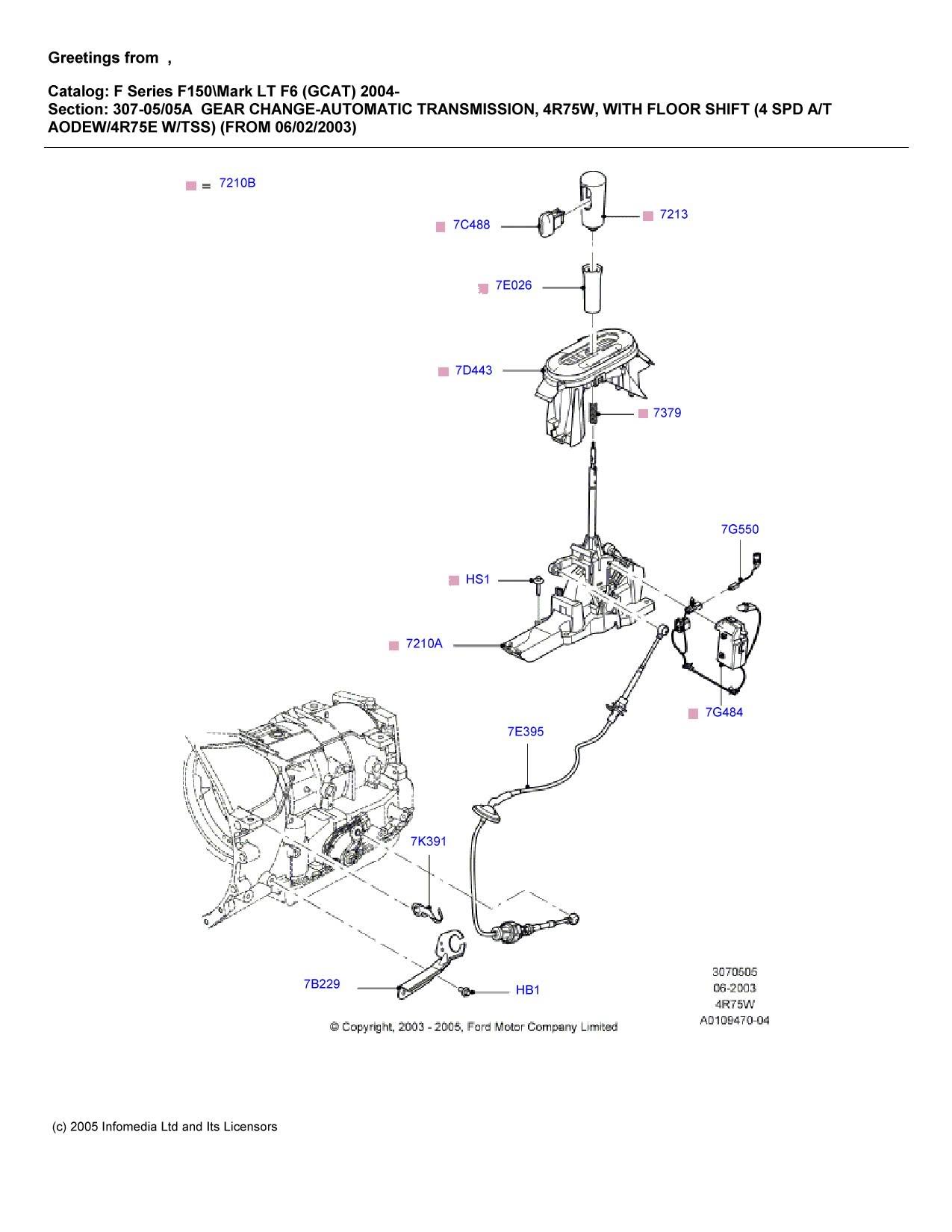

Actually fordparts.com has the shifter for $188.66 plus shipping, part number 4L3Z-7210-CD. Not a bad price and from the looks of the lower diagram (sorry for the size), the 7210 portion of the part number includes everything with a pink box next to it.

FX4&Excursion...thanks for posting the info about the shifter. I saw one on ebay, but it looked like it only included the top part of the shifter and not the part that actually bolts down into the console. I just went ahead and ordered one from Fordparts.com. I had tried looking it up on there before with no luck, but it's amazing how easy it is when you can just punch in the part number.
