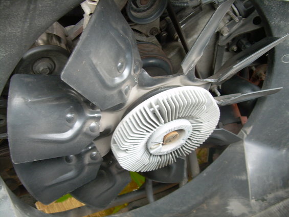

Lookin' like just four bolts on the pully and pry off? How bout the Triton style fan clutch?
Adrianspeeder

Could be that your clutch is shot or not actively engaging or whatnot. I've heard of problems with them.

Good point to bring up, but it is easily noticed lockin' up and goin to full roar.

adrian, i have a 97 4.6. it had the same problems until i dropped the clutch fan assy. i think its a flawed design there or the idiot light / needle is flawed... my problem was in summer driving on dune access road the needle would run mid way then rocket up to overheating and put the truck in that limp mode thing.
either way i dont like the clutch fan
consider going to e-fans? i never got my clutch fans to work. old or new.

Really, I've always read it was the other way were most people who do Efans just don't get the same air handling capacity and go back to the mechanical. Either way I can't get the dang clutch loose!

Quote:
Originally Posted by adrianspeeder
These are left handed threads right? Tried both ways and have been lubin' all mornin'. Got a big wrench with lots of leverage and a strap wrench on the pulley.
4.6L: 2 - Adrianspeeder: 1
Turns out to be normal righty tighty lefty loosey thread, just on there hella tight
After two strap wrenches snapped, and no steel plate layin' around, bit the $29 (discounted) and got the fan removal tool from the Tool Shed.
Well even if it cost double it was worth the 1min it took to remove.

adrian, my clutch's didnt ever seem to engage so i decided e-fans were my best bet... and seem to work when they are suppose to.
as far as removal of thee clutch fan, im surprised you couldnt get it off with a big crescent with a pipe on the end for leverage and a small wrench on the bolt to the waterpump pulley. thats how i got mine off twice.
Yeah, tell me about it. With the removal tools, half inch drive breaker bars, and two cheater pipes on that with dad pullin' on one, and me on the other it finally broke loose. Fawker was on there...
