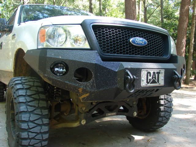

Here is my truck now:
Click the image to open in full size.
With my Iron Bull front bumper, that picture shows how much room I have now with 35x12.50 mud grapplers with only a couple thousand miles on them. Would I clear 37x13.50 tires without rubbing with 1.5" spacers in the front? Anybody that has 37s: are you closer to rubbing on the front bumper or back edge of the front wheel well like my picture shows? My front bumper has room for 40s, it's just that rear bottom edge of the wheel well that might rub

I got it from somebody on craig's list brand new for $1200. They sell for $1500 or $1600 normally. Then add a few hundred more if you want any kind of brush guard or grille guard. The winch mount is behind my CAT plate, I just didn't like seeing the empty hole til I can get a winch
