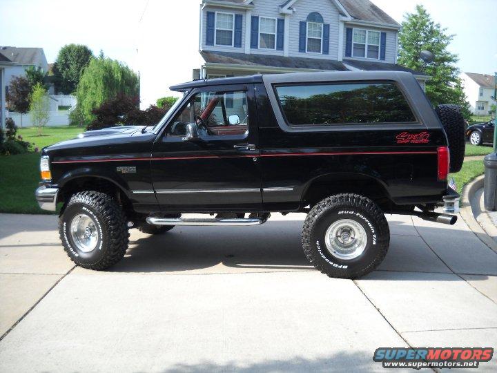

ok so just picked up a 6" fabtech lift used came with coils struts and everything for a bolt on ready kit. my buddy at Giant bent the beams to pull 2 more inches out so its about 8 in the front 4 in the rear.
now I need to get tires im not sure how 33's will look with a lift this high so im not sure about 35's yet. does anyone have any side shot comparisons of the two?

Here is my up six inches on 35's.
