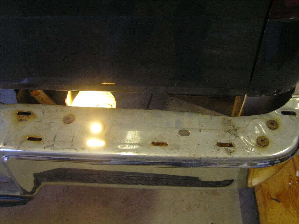

The rear bumper is held on with six flat, torx-head, bolts (on top) and two 13mm bolts (underneath).

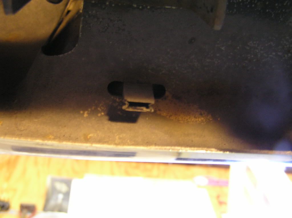

This is held in place by 16 molded-in plastic fingers that push into slots on the bumper. This is what they look like. A pair of 6" slip-joint pliers works perfectly to squeeze them as you push up, (start at one end).
Be patient, and try not to break 'em....a new bumper cover is $142.
Now with that removed, you can get at the top bolts.

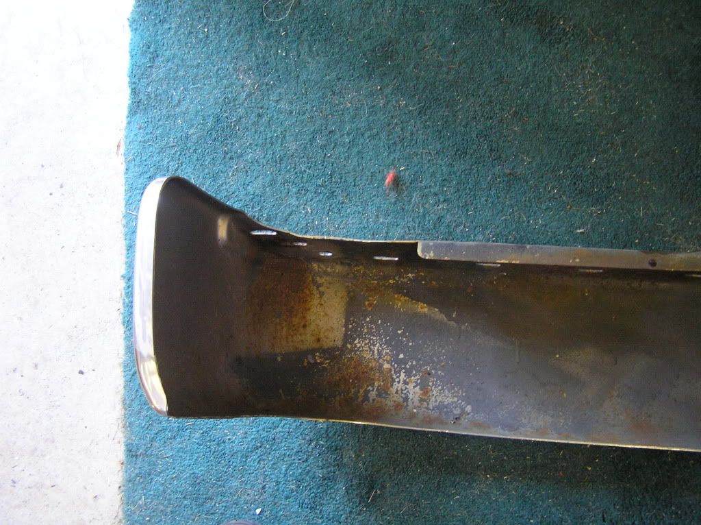

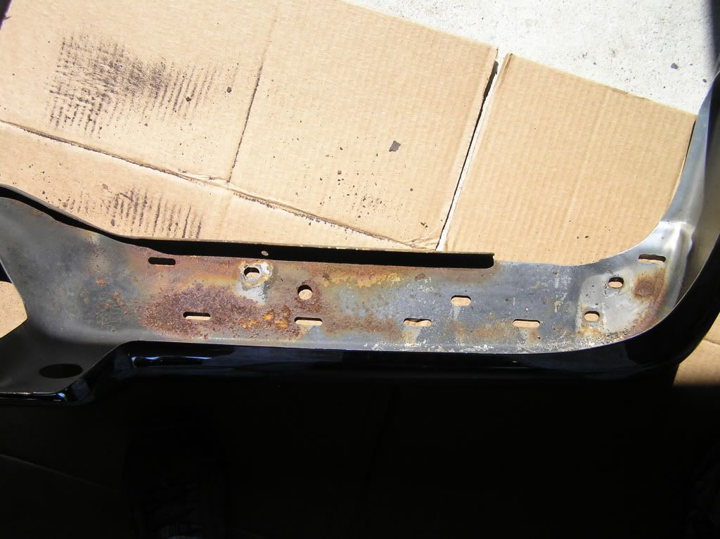

Here's some pics of the rusty back:

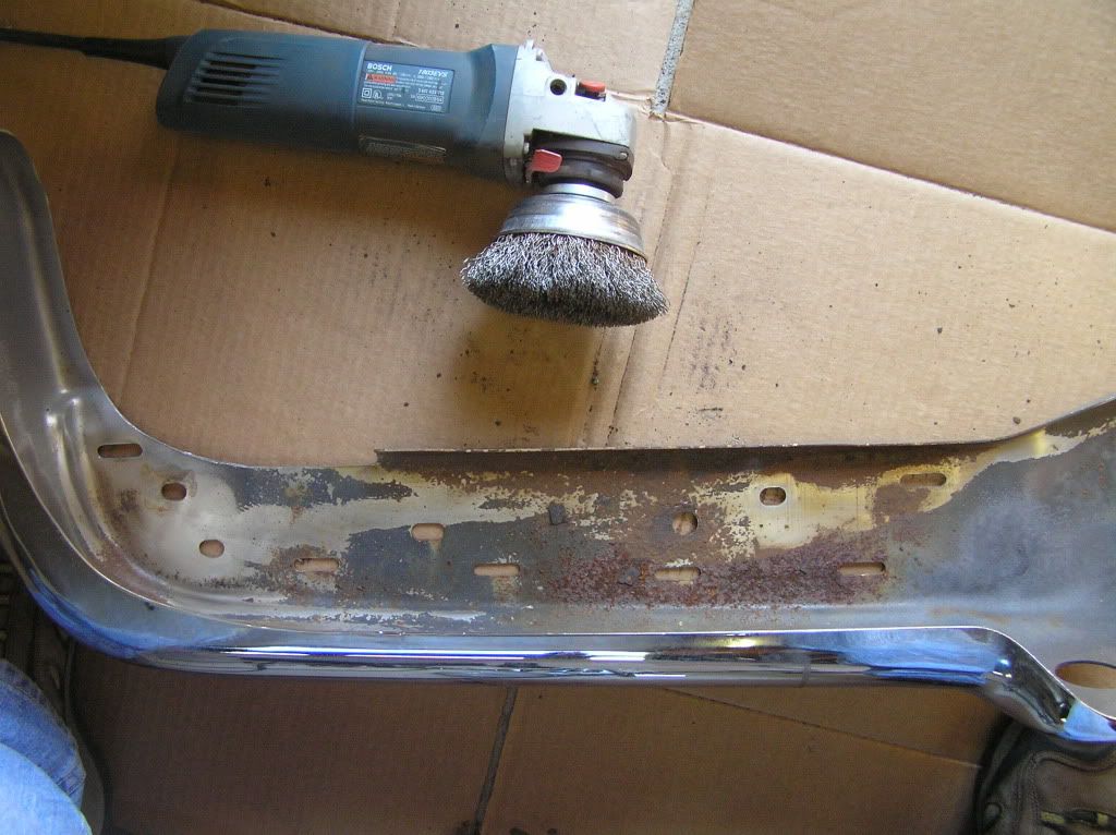

I used my grinder and wire wheels to clean it up...

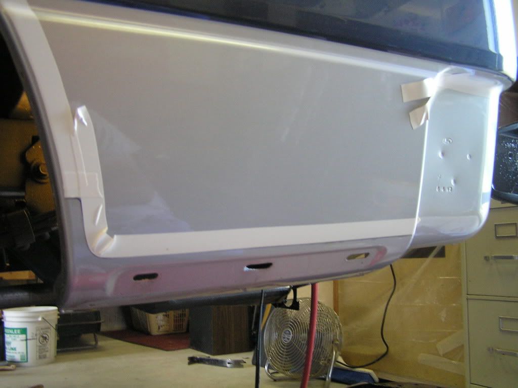

Prior to removing the plastic cover, I marked where it covers the bumper, so I could paint under it. I did this with POR-15.

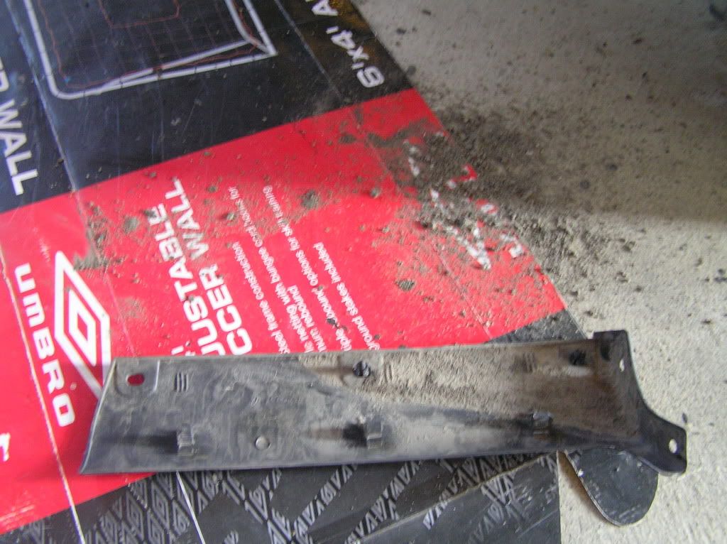

While I was at it I removed the rear, plastic rocker covers.
The dirt was held in there.
I also masked and painted under these areas, (Rustoleum Hammered Silver).
