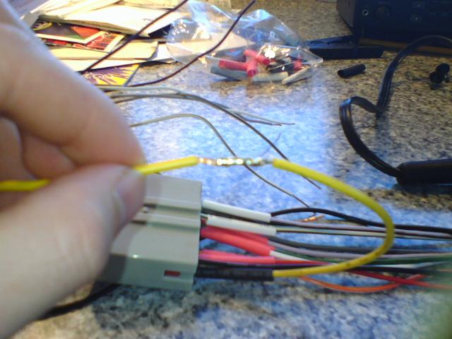

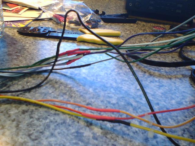

I carefully took the time to solder and heat shrink the wires for the adapter for the head unit. I've never had a problem, plus it is very neat.
Soldered.
Heat shrink.
I don't skimp.
In fact, when I redid my fog lights, I soldered and heat shrinked everything. Haven't had a problem since.
