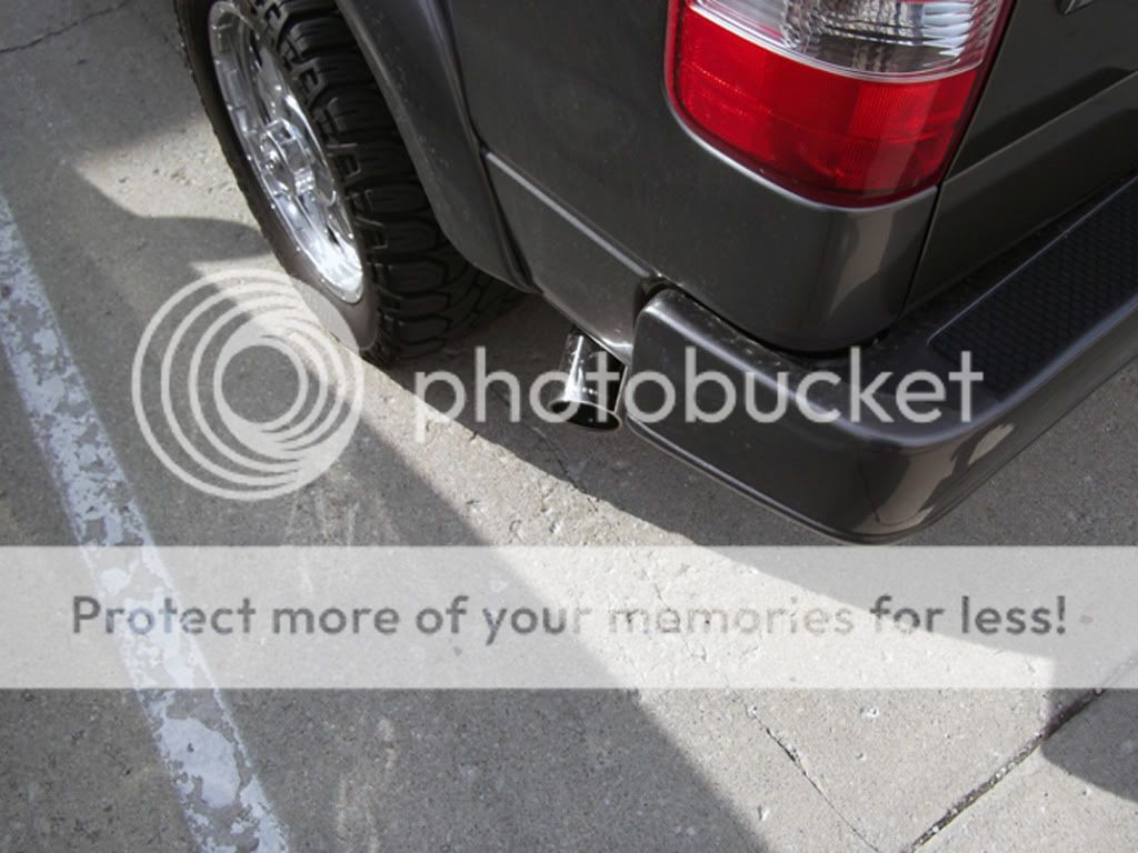

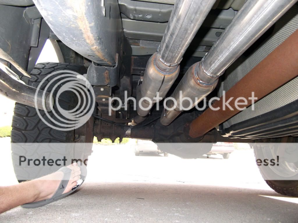

Well It's Here... and It's Done
Well I was going to update my other thread, but I figured this was much easier.
I figured I would share all the details of the build, including prices, links, and any information I picked up along the way. And of course there will be videos and pictures to go along with it
My Truck:
2005 Ford F150 FTX SuperCrew
- 5.4L Triton
- Roush Supercharger
- VMP 93 Custom Tune
Exhaust Setup:
2.5" True Duals
- MagnaFlow High Flow Catalytic Converters
- X-Pipe
- DynoMax Bullets
- MagnaFlow SS Tips
- 45 Degree Angled
Parts & Links
High Flow Cats:
-- Magnaflow Cats (# 94106)
-- 2.5" In/Out
-- 15" Length
-- Price: $49.46 per
X-Pipe:
-- Ebay Listing
-- 2.5" In/Out
-- Stainless Steel
-- 12" Length
-- 2.5" x 4" Core
-- Price: $29.99
Mufflers:
-- Dynomax Bullets (# 24215)
-- 2.5" In/Outlet
-- 12" Long x 4" Diameter
-- Price: $39.95 per
Tips:
-- MagnaFlow Exhaust Tips (# 35117)
-- 2.5" inlet, 4" outlet
-- 18" long
-- Rolled, Stainless Steel
-- Price: $48.25 per
Info:
- Performance Peddler Promo: clubgp
- Put X-Pipe as close to stock Y as possible
- Weld 02 Bung AFTER Cat
Video & Pictures
Old Exhaust:
New Exhaust:
Well, hope you guys enjoyed the vids and pictures. I can try and answer all questions about the setup.
The "New Video" was my first attempt using Adobe Premier. I would play with it and see how it came out. Little disappointed how small the pic's and intro/exit turned out. But I will only get better with time.. It's much better if you make it full screen. Not sure what the video glitches is about.
