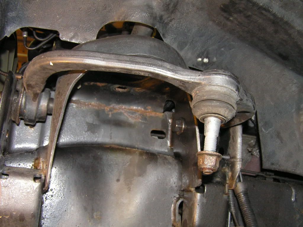

>>>If you are NOT replacing the upper control arms, the next step will need to be done without damage to it.<<<
Since this just makes the job more time consuming, plan on replacing these.
Remove the upper ball joint nut.
Beat the stem-end till the ball joint pops out, or a few whacks on the cast spindle arm may do the trick (like in the video).
>>>After this separates, push the stem back through and put the nut back on with a few turns, (it helps hold the spindle from falling on you after the next few steps).<<<
(In this pic it's been loosened and put back through.)

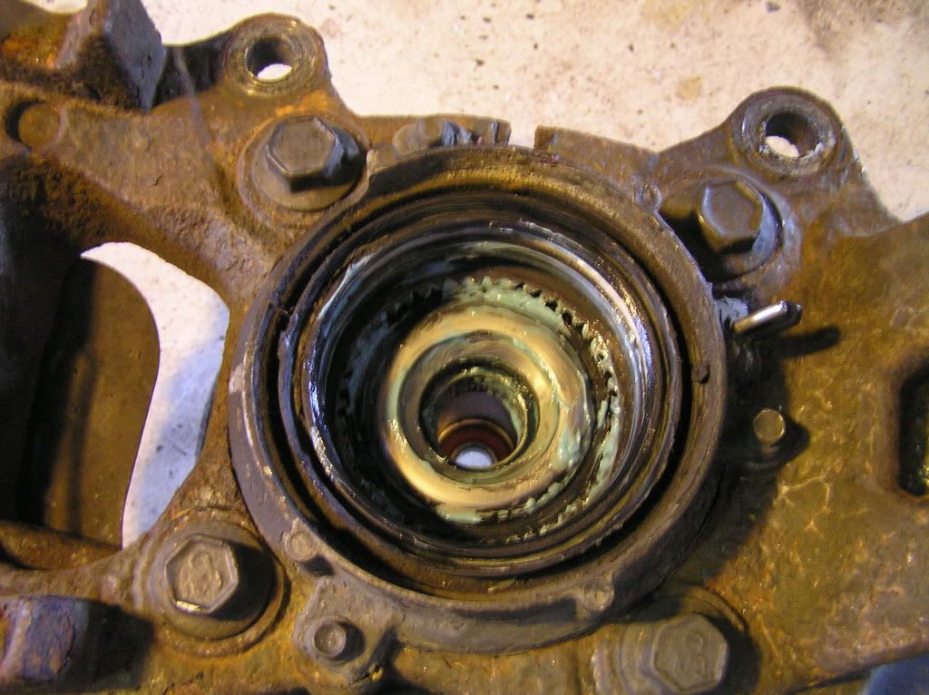

Next I cleaned and re-greased the 4wd engagement-gears and
reinstalled the spindle....
