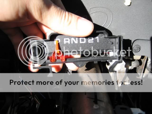

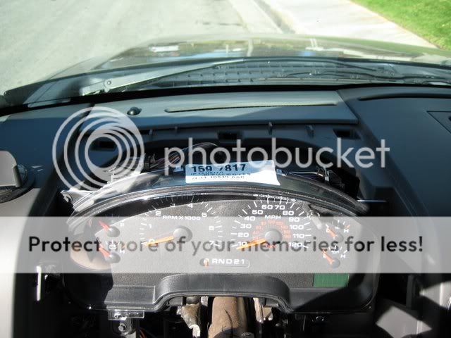

Quote:
Originally Posted by lsracer View Post
Instrument Cluster (easy way):
Step 1:
Remove the lower two screw on the bottom panel.
Step 2:
Remove the 2 screws on the upper panels that you just exposed. The little black ones.
Click the image to open in full size.
Step 3:
Take your fingers and run them up the edge of the panel, to get the clips off.
Step 4:
Now you should be looking at the instrument cluster, remove the 4 screws.
Step 5:
Remove the two plugs.
Step 6:
Remove the shifter by squeezing the two tabs.
Step 7:
Take the shifter out by removing the red cord.
Odometer Backlight Repair
