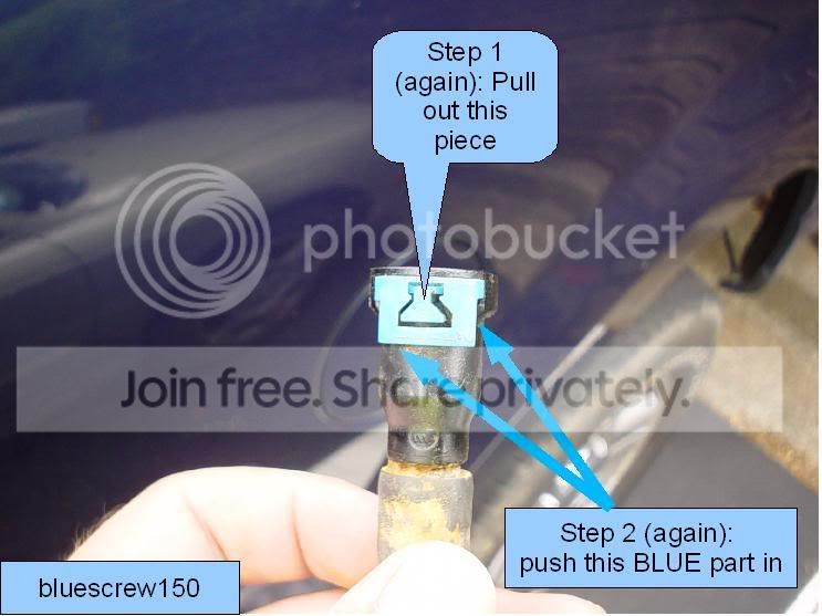

I took some pictures of one of my blue clips ( I have a ~12" piece of extension hose I guess because of the 150" wb. The hose has blue clips at each end so I could take off real easily) and put the pics up here to maybe put an end to *slash* help out with the redundant posts asking questions about these things.
All you're trying to do is open up the fitting so that your filter flange can come on out freely. Scroll down.
Here's looking into the line (towards the tailgate). The picture does all the 'splaining.
So follow your step 1 & step 2...
Here's looking at what most see when they look at the blue clip:
Step one does this:
And step two does this:

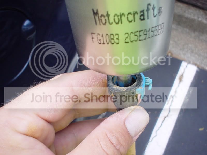

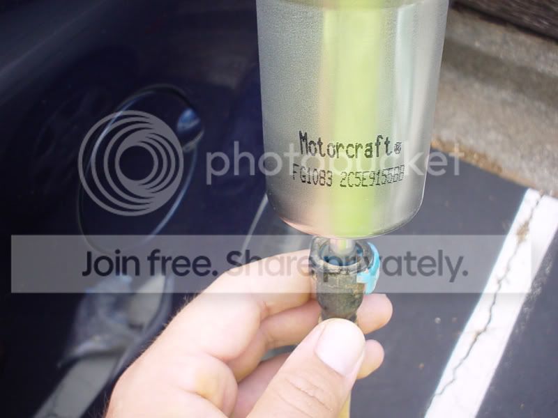

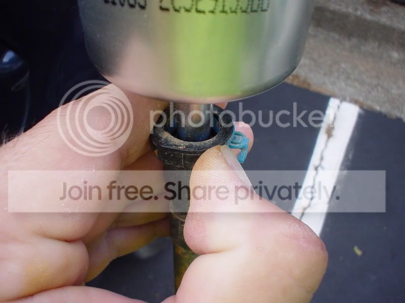

So here it is again, with a filter up in it:
Start with this:
Step 1 yields this:
And step 2 yields this:
