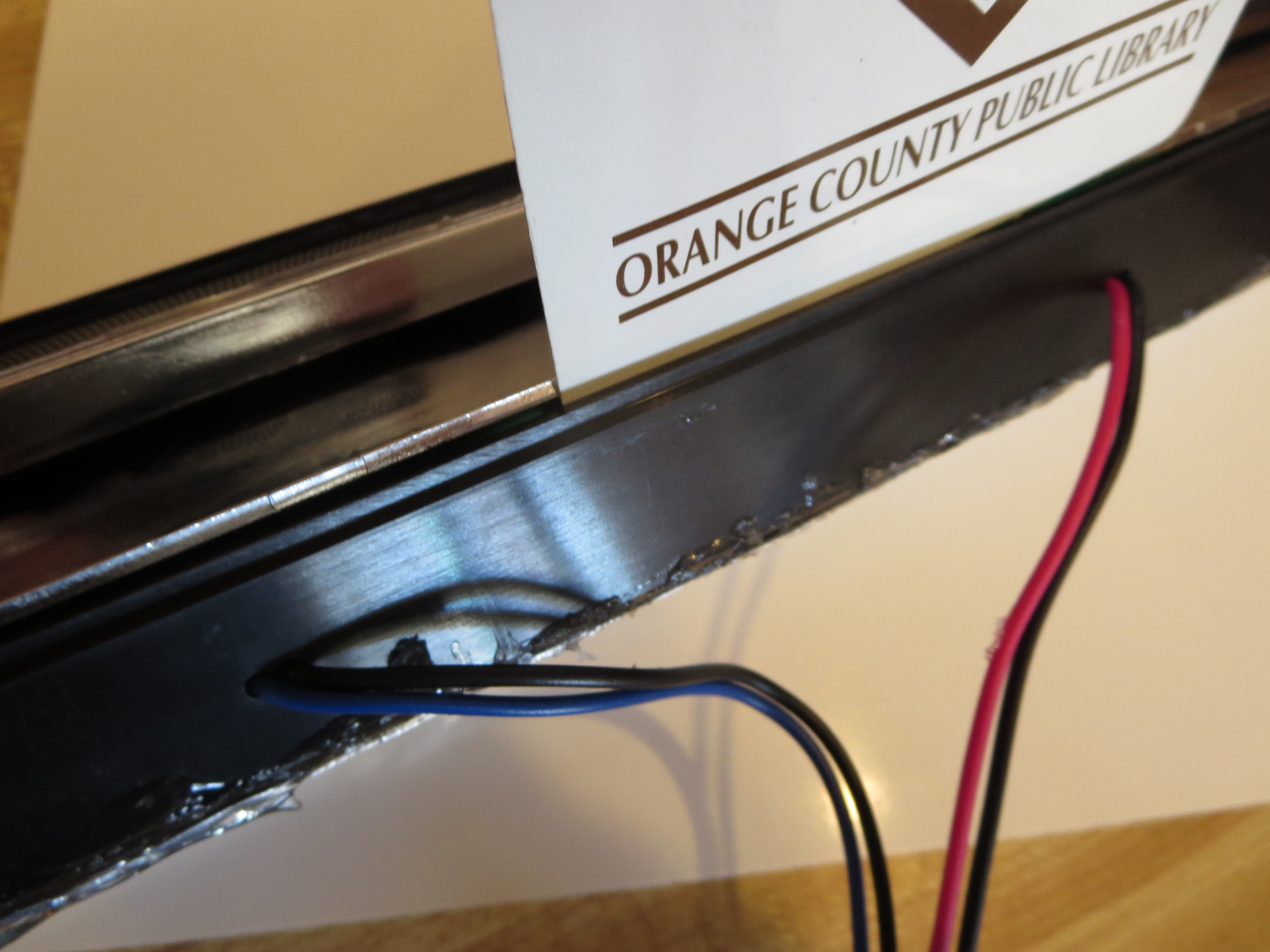

I did find that the back of the light, where a plastic cover should have been sealed to close off the inside electronics, was not glued completely and left some gaping holes for water to enter. I included one photo where I could easily stick a card in the gap. I ended up applying a sealant around the entire opening (and some odd little holes in the back as well) to weatherproof it.

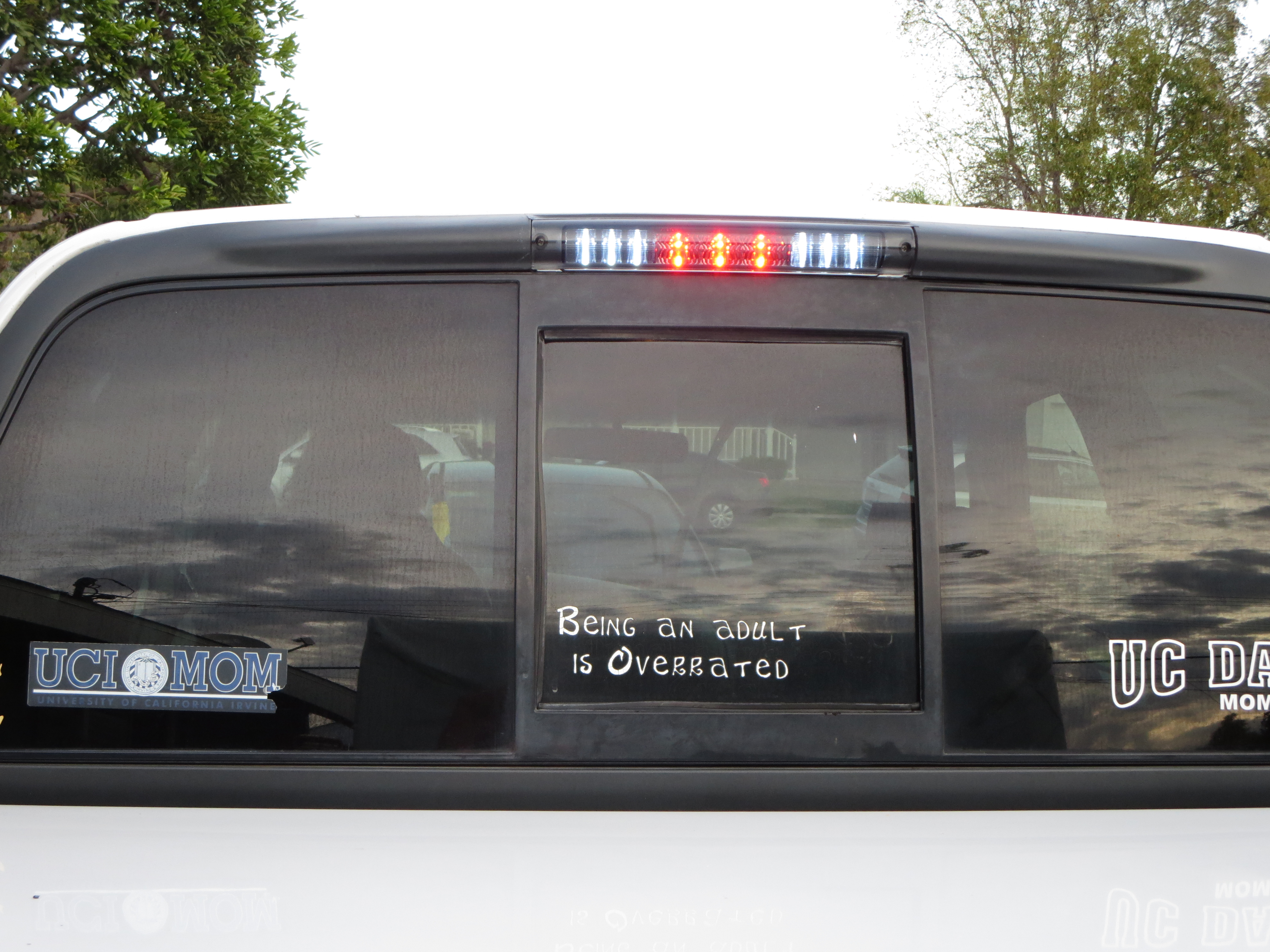

All said and done, I am finished with this project and will live with any imperfections. As others have said, the light is not as bright during the day as the original. But it does work well enough and at night it lights up great. And the final look of the light is very nice as well. That smoked plastic blends into the trim of the truck.

Blink187. Without the gasket, did the installation leave much of a gap between the top back part of the light and the trim? I installed with the gasket but I don't know that it's pushing the light out that much. I might have need to reroute the wires a bit. They might be a problem as well.
The foam was just really cheap with tape-adhesive on both sides it was not going to fill the gap between the light and the window trim, or keep any water out...I did not use it.
Also, I popped the rubber plug out of the body and reused the hole to route so my wires where not bulky behind the light, and dremeled the light housing to fit flush, then I sealed the gap with silicone, before snugging down the screws.
